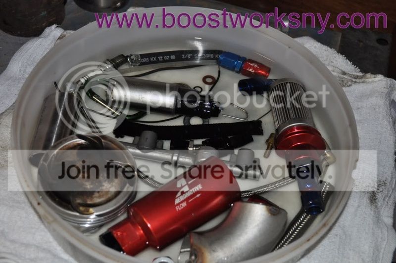

Made the switch and as I said I'm about 6 to 7 months in and started noticing fuel pressure loss under load. So out came the fuel filter and it was plugged with a black rubber sludge.....fuck.
So I pulled the hat and found this
Compare to new ones.
So I ripped out all my lines and ordered new PTFE lines.
Moral of the story?? Don't believe everything a stranger tells you over the phone.
No rubber line is safe with e85.
I also had my injectors flow tested and thankfully they were still ok. Even though there was black sludge on my delete plates showing that sludge had gone through the injectors.
So E85 users. Learn from my stupidity. Please.

It's not the hose, although you should use 30r10 hose if that's not what you have, its best suited for in tank use.
Where do you get your e85 and how long has the station had it?

There have been quite a few tests done submerging everything from nylon braided to even common rubber heater hose line in e85 with nothing breaking down or causing black stuff. It is hit or miss for this to happen even with identical fuel systems and the only plausible outcome from testing these theories is it comes from not cleaning the fuel storage tanks after converting to e85. And the other from inside the fuel pumps themselves.
Most will recommend checking your system a few months after switching and replacing filters as needed or finding a new station. You have guys that have filters that look new after a year and others that have this after one tank.
The most common find was stations using diesel storage tanks for e85 and not cleaning the storage tanks prior to switching, the e85 starts dissolving all the gunk and then it ends up in your car. The other was pumps with parts not compatible for e85 use.
My recommendation would be to put those e85 specific pumps in and ensure you have 30r10 hose on the hat as its the best choice like mentioned.

Those gunked up black fuel socks are the 1st thing the E85 see's! That's coming from the fuel in the tank, not the rubber hoses.

Well you have to remember that when your running a full return fuel system, fuel makes it back to the tank over and over again picking up debris from decomposing hoses. Not only is the inline filter going to see this, so are the pump filter socks. When I installed my Fore Level 4 kit it came with all stainless braided Teflon line. Been running the corn two years with no issues.

Your tank looks fine anything that was there looks to have been cleaned, what about the tanks from the station?
Here was one of the tests, all materials were left in e85 for a year and ahalf, no corrosion, no paint wear, no rubber break down on any of the hoses, nylon braid, stainless braid or even the 30r6 heater hose.

Just look around the web, there have been lots of test over the past 5 years, disproving (or rather uable to prove) rubber break down from hoses. You can't replicate it. Just was the easiest thing to suspect at the time.
There is a lot of these tests comparisons on svtperformance. That's where you can see a guy with a lethal fragola push lock rubber hose setup run 2 years on e85 with filters that look new, and then someone else with the exact same setup experience what you have after a couple months of e85 use.
Same for fuel hats/pumps, guys though it was black anoidize coatings on hats or pumps, but then you get the black stuff on setups with no coatings.
Then you suspect pump internals for non e85 rated pumps. But again you cant repeat it, one guy will get it and the other no issues on the same pump be it e85 rated or not.
The only variable is the e85, where you get it from and what part of the country your at etc.
