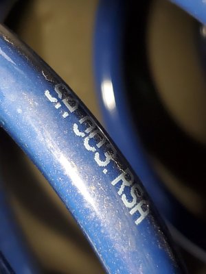

I have had stock, BMR, Ford Racing and Eibach springs on my car and I have never seen any that fat. they do almost look like front springs but I know the spring perches are different sizes front to rear. All of my rear springs have looked similar and much narrower than the front.
The Steeda Sports have a much smaller diameter spring than the Ultralite. I have no idea why, but even on their site they are represented as such.
As for the direction of the progressive rear springs, I remember doing research on that when I originally installed them, and I generally found the answer to be the tighter coils go down, but I can't say for certain on this. I'll ask Steeda when I send them the part number on the springs when I get home.

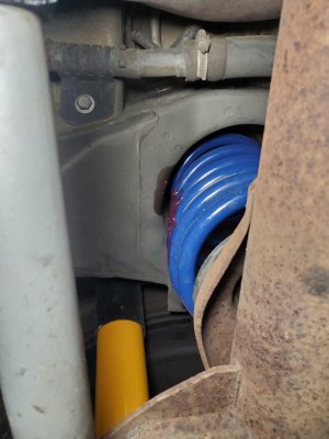

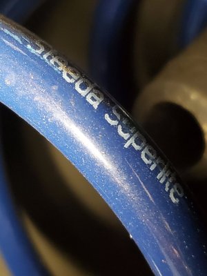

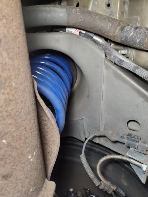

Ok I put the car back on the lift and here's some better pictures of the springs. I also confirmed that the text on the springs is right side up. I'm sending this to Steeda to see what they have to say.

I was looking at the pictures you sent & it caught my eye just now that it may appear that the spring seat on the axle tube may be a little out of alignment causing the spring to bow out in the center between the 2 spring seats, but this may be due to the camera angle so it may not be a contributor.
Something else to maybe check into if the new springs do the same thing.......
Thought I'd mention it.

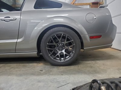

Lower control arms stock length? Rear wheels centered in the wheel opening? Looks like the axle maybe too far rearward.

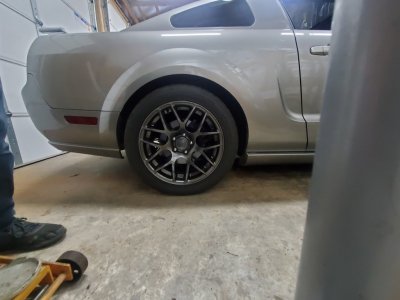

Take a side photo of the rear wheel/quarter panel w/car sitting level. And post it.
You could also measure wheelbase on each side. Compare to published wheelbase.

Ok just took some pictures, and also tried to measure best I could. I came up with 107.5, which does seem to be about .4" longer than factory specs. So if this is the problem, what do I need to do to fix it, and why is it like this? Doesn't everyone else run standard length LCAs on lowered cars? Thanks.

The left side definitely looks to have moved rearward, right side shot is a bit dark. I can measure a stock arm length bolt hole center to bolt hole center and let you know.
