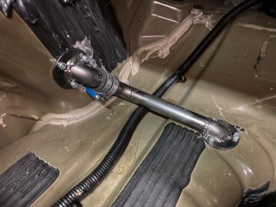

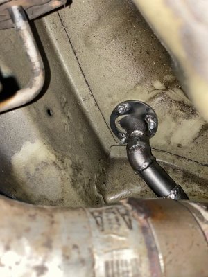

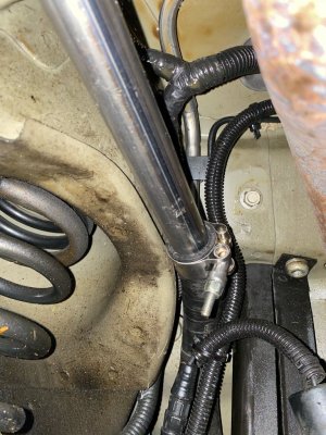

Hi.
Rerouting the filling neck pipe, and bypass the tank-vent just before the Evap-canister works for me.
The two problems Ford has made is a fuel-trap in the filling line, and no backvent before the evap-canister.
……. There is no magic, just do it like all other cars. :) :) ( earlier modern mustangs, and later do it right.)
Don`t know what Ford was thinking about, when they designed the fuel filling system on the 05-09 mustangs. ? …….. it`s against all rules of nature. ❗
Filling issue must be bigger in EU , because we pump with 13 GPM here , and only 10 GPM in US.
The clear hose with the ball valve will be opened for each pump…… Later this year this line will be routed to a nozzle close to the fuel filling hole. ( in top )
