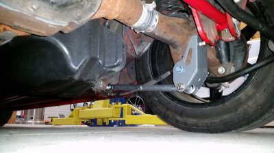

Does that look right?
Depends on what was intended and whether the offset is toward the outside (tire side) or toward the inside. There is a slight effect on axle roll steer and another on what happens to the thrust angle as the axle is adjusted laterally (typically for "centering" purposes).
Norm
Ahh...
looks like I'm going to have to do more research!
