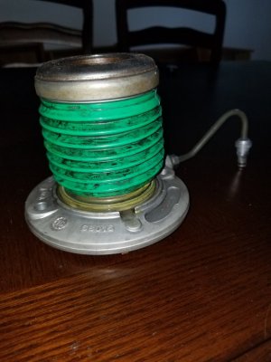

Problem is, you don't "KNOW" that the slave marketed as "Ford" is any different than the slaves marketed with another name. Nowadays, the same plant will kick out parts for different distributors that market the with their own brand. Hit or miss.
Balthazor72
Aug 5, 2017
25
This was Exedy, but it doesn't look any different than the OEM I pulled out when I changed my clutch.
