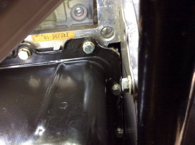

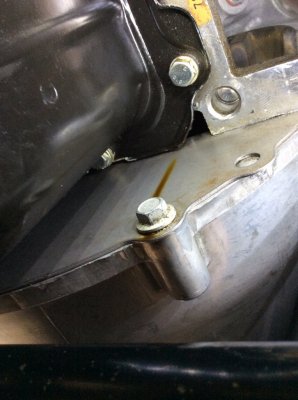

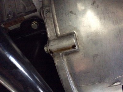

Please look at pics and tell me where this oil leak is coming from. New OEM rear main seal and seal retainer plate last summer when I installed the clutch. Going to retorque the oil pan gasket bolts, (pan has never been off).

Rear main is leaking. What seal did you go with when you did the clutch?

Installed a new Ford oem rear main seal, and new Ford oem retaining plate. Did everything to spec, hate the thought of having to pull the trans again!

It's more likely than the oil pan leaking, I hate to say if but it seems the rear main is bad about this problem.
Clean the oil up really good and recheck it later. Could be from the valve cover running down the back of the block.
It sucks there is no real way to look inside the bell housing through an inspection cover like the old days.
My bell housing has an inspection hole on the bottom.
If the oil pan has never been off and you replaced the rear seal then it is likely the rear main seal leaking.
Did you install the oil slinger along with the rear main seal?

New OEM seal, slinger, and plate. Took extra care to do everything to factory specifications. Not a job that I want to tackle again.
