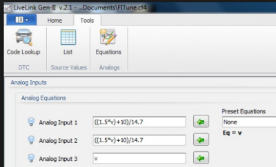

Unfortunately, the analog 2 is calibrated as a narrow band, so I have to reprogram it to read like analog 1. To do that, I probably need to buy an adaptor to make Innovate's archaic serial cord marry to my laptop.
Nothing is easy. I just want the tune right and then enjoy the car.
You lost me here. Analog 1 & 2 is Livewire lingo for getting data from accessory gauges not connected to the stock OBD system. With the right voltage conversion factor, you can log whatever you want whether it's a narrowband or wideband o2 sensor.

Yea, the default for the Analog 1 of the Innovate is programmed to output between 0 V for an AFR of 7.35 (gasoline) and 5.0V for an AFR of 22.39.
Analog Output 2 is 1.1 V for an AFR of 14 and .1 V for an AFR of 15.
I *think* I need to make Analog Output 2 match that of the Analog Output 1. If I do that, does the SCT X4 read it correctly when datalogging, or is there some change calibrating I still have to do on the SCT X4?

Yes that is what I did for mine. I believe it was the brown wire out of the Innovate that I connected with the SCT firewire. No other calibration is needed besides applying the equation for converting volts to AFR.

Addict, the o2 was calibrated during install consistent with what you said. But now, when I reprogram the Innovate so that the Analog 2 output matches the Analog 1 output (via Innovate's downloadable software), no other actions are required for the SCT software to properly read A/F numbers from the Innovate, right?

I did not do any extra programming with Innovate's software or with SCT. My understanding with the Innovate software is that you can use it to adjust the range of your min/max AFR readout if you wish to reduce the resolution for more accuracy. You can also adjust the wideband response speed through this.
But nothing else is needed to get started.

Okay, but if you used the Analog 2 output from the Innovate, you had to change the AFR conversion numbers (or LAMBDA) within Innovate's software so that Analog 2 matched Analog 1, right?

Yes, that's what I meant earlier when I said conversion factor. You go into the Equations tab in Livelink and enter the formula. For the LC2 it's (v*3)+7.35 which is also one of the preset equations for LC1 in Livelink. This is the formula for AFR. For lambda you will need something different.
