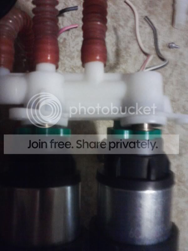

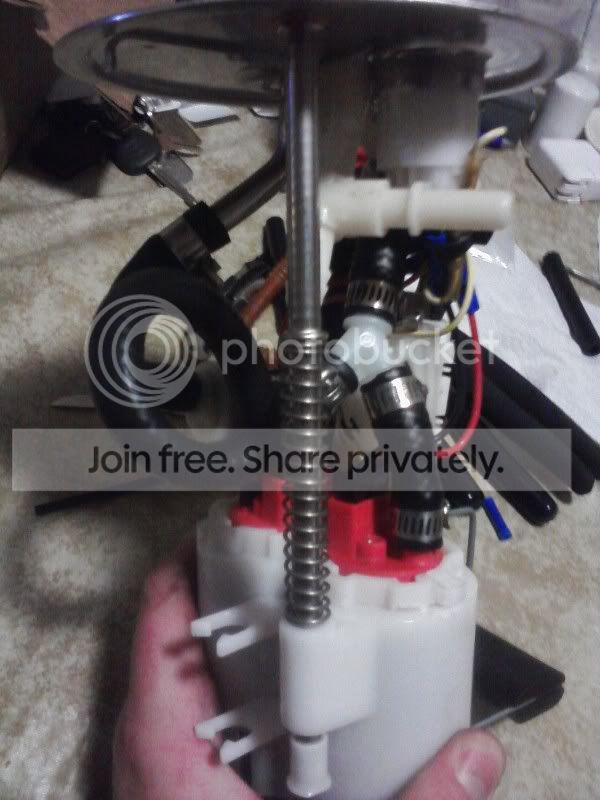

Yup, a key part of this upgrade is ditching the factory pump assembly's T fitting and going to a larger 3/8" Y fitting that doesnt restrict flow.
Stock gt500 hat setup
And here is upgraded to new hose and larger y fitting.
