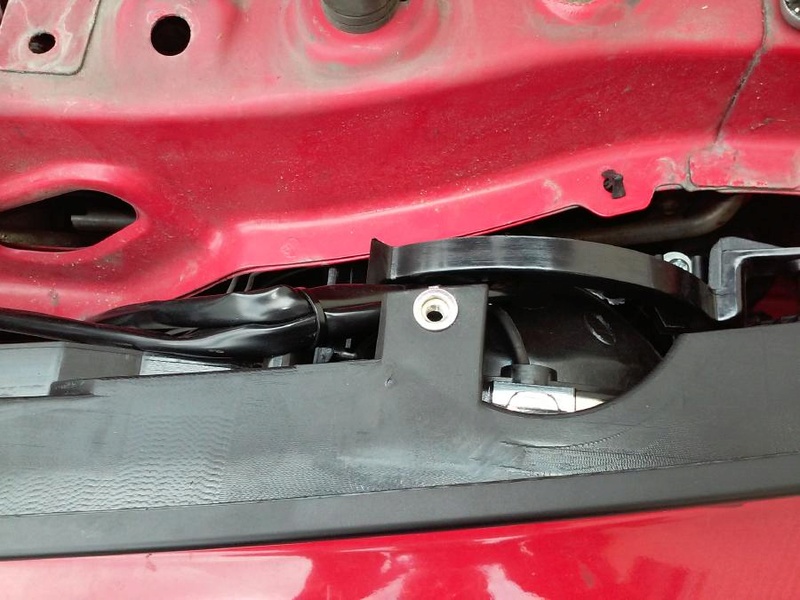

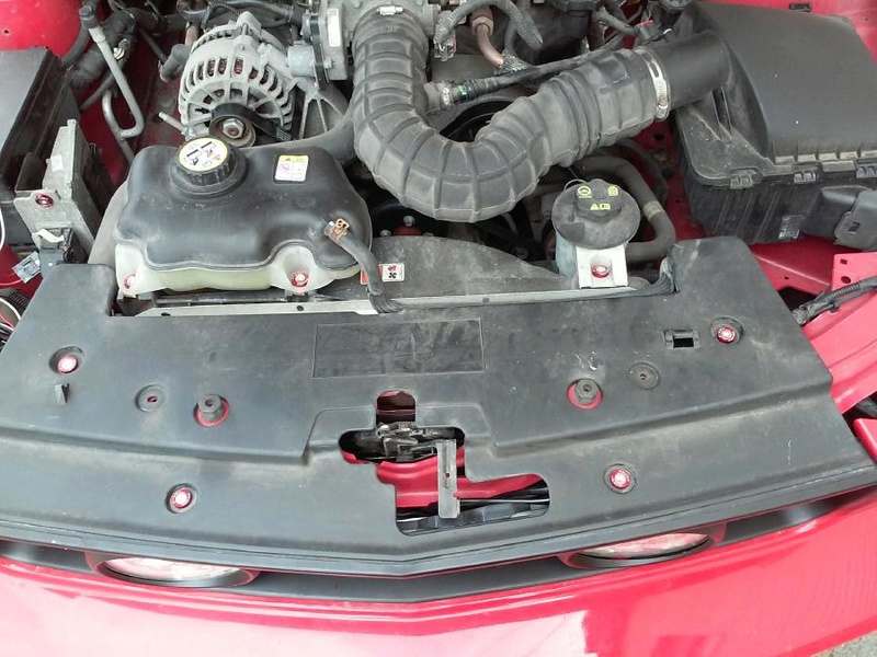

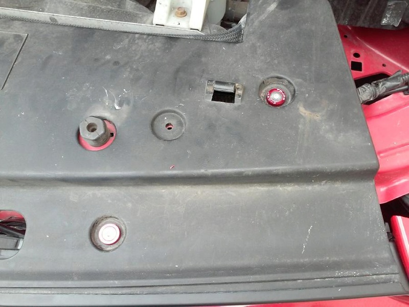

Advance auto has many different push in fasteners. You can always go with
a larger size, and drill out the holes to match. I use plastic rivets, then drill
them out if I need the liner out. You can also install well nuts, or what they
call rivet-nuts and use stainless bolts so you never have to worry about
that again. I installed them in my cowl front radiator cover so I just
unbolt it, using stainless dress up bolts and red washers.
Great idea !

I just ordered 50 aluminum M6 rivet-nuts and 20 more of those dress-up bolts. I am going to
do my fender liners with them.
I may do the hood-liner first... Those bolts and red washers are relatively cheap.
