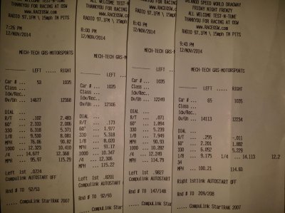

On my 3rd pass last night i held 3,200 rpm then nailed it and Spun a whole heck of a lot....60ft was a 2.09 and i ran a 13.28-
With slicks i'm sure i could hold even more rpm but i really don't feel like replacing a broken drive shaft as of yet-
I was not going to leave after that pass lol so i ran a 4th time and then ran the [email protected] and that 60ft was 1.69-
It's not where i want to be but this was only my 2nd time to the track with the converter so i am still figuring how to launch the car...

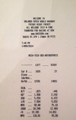

Went back to the track last night in 42 degree Orlando weather and 1st pass i launched at 2,800 rpm and blew off the tires ran a 2.11 60ft @12.69 But ran my Fastest mph yet....116.41
Second pass i launched around 2,500 rpm ran a 1.87 60ft @11.97 at 115.04 mph-
3rd pass i swithched to a Bama race tune and ran 11.88 @113.78 mph...
