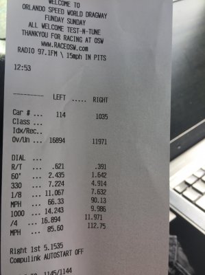

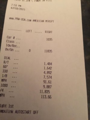

Made it to the track yesterday and finally got the 11 second time slip I was looking for! Data logged the runs and first gear shifted at 6,100 rpm and the second run shifted at 5,900 so I sent them to Mike and just waiting for a revised tune and then bact to the track I go-
60ft dropped from high 1.80's to 1.64 and 1.67-
Best mod yet is the Converter!

His sig says circle D 5C,m. Have you done a converter swap since you started this thread?
Yes i just added the converter recently...my best with the stock converter was 12.18@116 mph-
I do not think i was spinning and Mike told me today to leave at a higher rpm because i should be able to get 60ft's in the high 1.50's
My rear tire is 28" in height...
I will try again on Wednesday night...Mike tweaked the tune today and said with a 60ft in the 1.50's i should get into the 11.80's...I will let you know what happens-
Thanks guys-

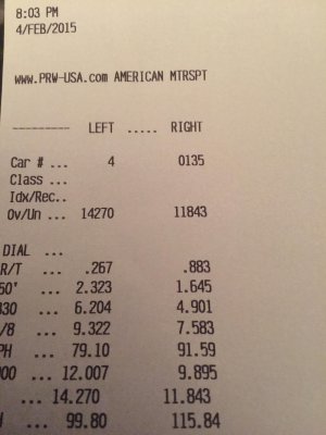

I'd like to have your car for some 1/8 mile bracket races. Identical to the .000 on the last two pictures!
Lol....As you can see i am still getting use to the converter once i do then i will focus on R/t...

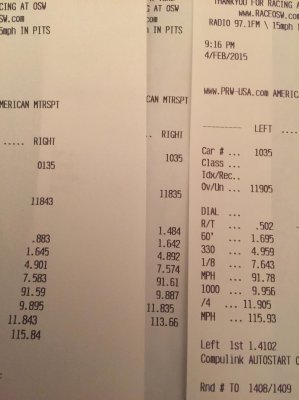

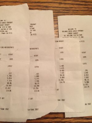

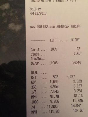

11's again-
Made it again to the track....though i did not run the revised tune because i had some issues with it-
Once again 1st gear did not get pass 6,080 rpm-
I'm Lovin this Converter!

Getting better! That's about the same 60's I get, I did get a 1.60 one time lol. What kind of da are you running in?

Your 60s look better More consistent. Better track prep or you found a better tire psi or better burnout. Your first set was all over the place. Good work just keep at it and keep some notes
