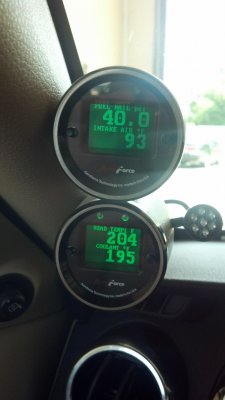

Blackout Intercooler
temps are now normal
