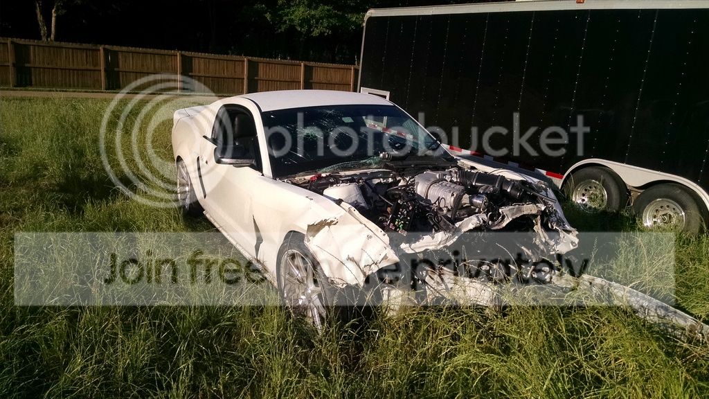

First and foremost, I'm very glad your son is okay from the wreck, that totally sucks but of course the car can be replaced..

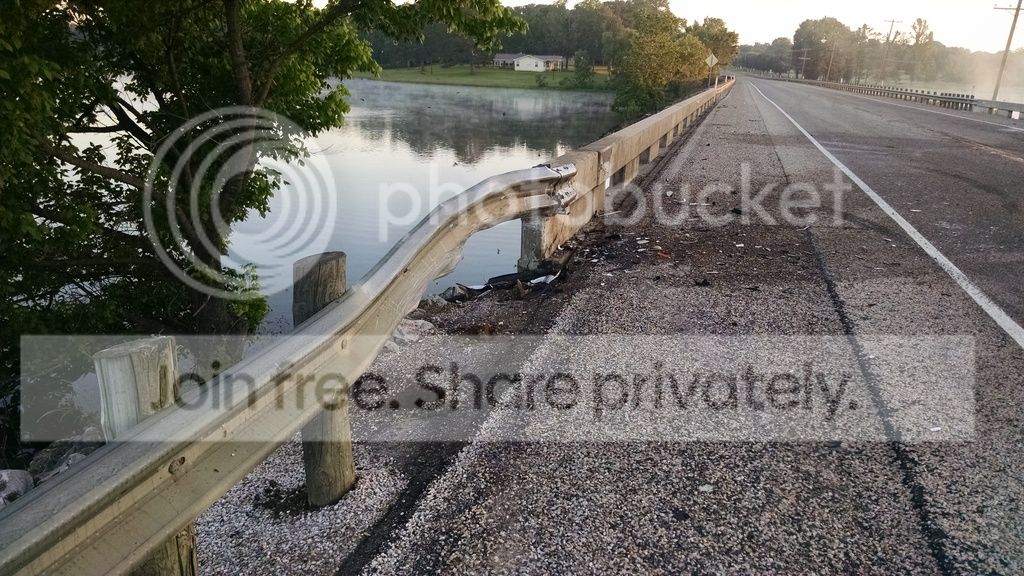

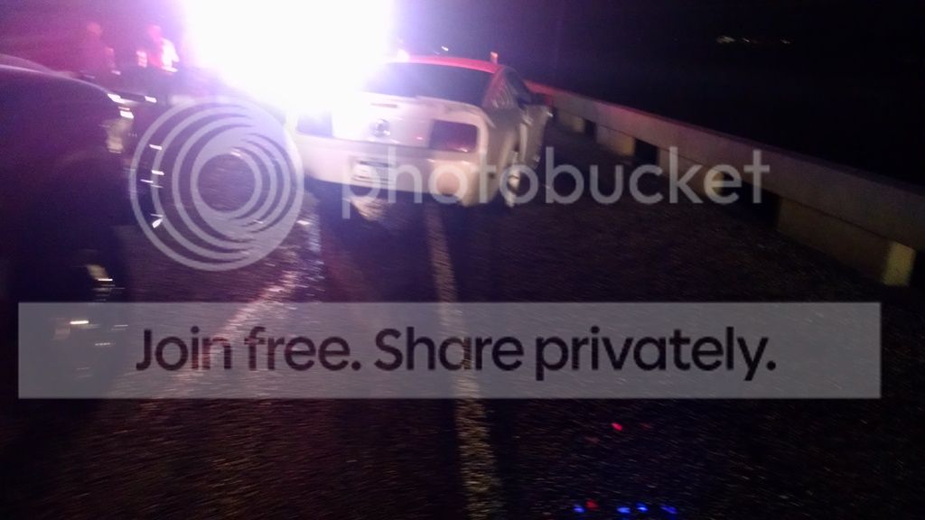

Thanks, his accident could have been WAY worse! He took an 70-80 mph hit at a 45* angle best we can tell and after the passanger side hit the concrete barrier, the car spun three times before coming to a stop. Thats why there is so much fluid on the road.
