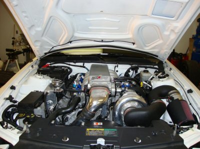

where does it mount. these covers actually gave me more clearance.
I didn't see your reply, the reservoir mounts on the passenger strut tower. Here is a pic but it's not the greatest to see.
spyder7724
Apr 21, 2007
854
10
Maryland
wow thats tight in there. it would probably fit with the moroso valve covers but the stock ones would be really really close. the tank may have toraised up for clearance. thanks for the pic.
