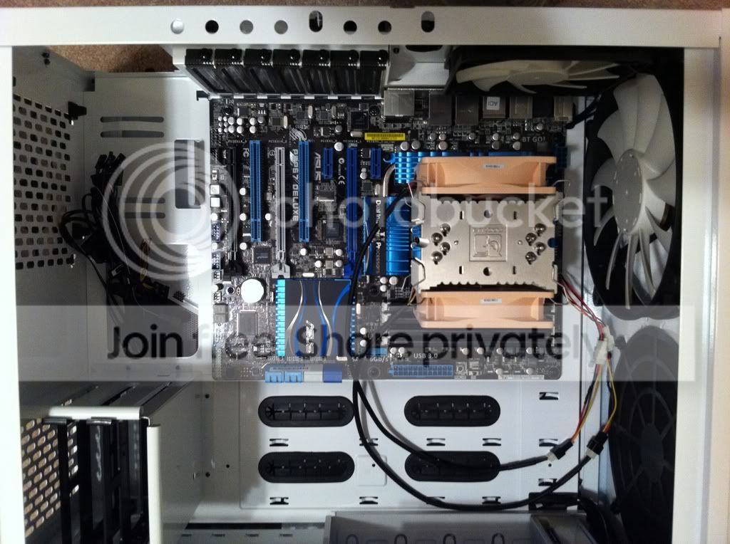

I wanted to take more pictures along the way including unboxing, etc but it never works out that way for me. I just wanted to dig in! LOL. Anyways, I'm pretty much done. I just need to get some 3.5" to 5.25" adapters for a card reader and the 3.0 USBs for the drive bays. Need to boot it still and load OS. Since the case is so big I'm putting it on the floor but decided to build a stand that is 3" tall to get it off the ground a little bit.

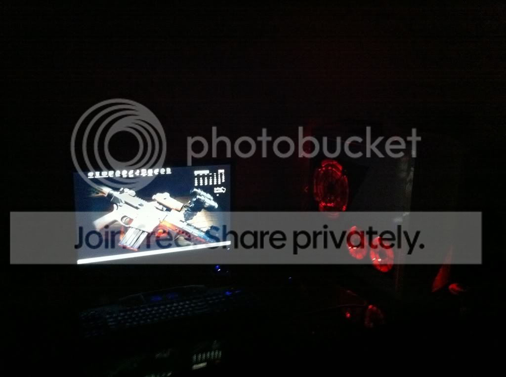

Nice. Looks good man, congratz on getting it sorted. At least your case fans are fairly dim. My case lights up my room LMAO.

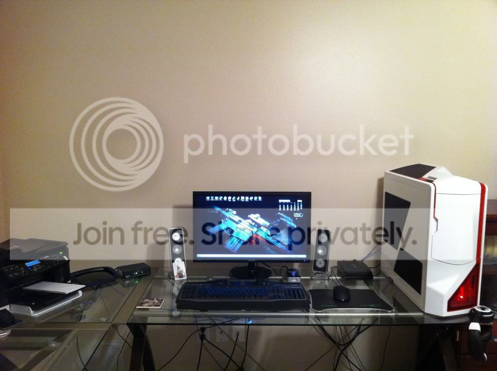

Very nice, but you need a bigger screen to go with that baby!
I think it's just the fact that the case dwarfs it. It's a 24" screen. LOL
