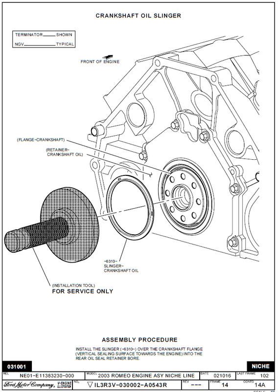

If you are into the motor that far you should consider changing the rear main seal too... Even though it involves the tranny removal and clutch removal. There is also a plastic "dust seal" (Ford part is labeled as an "oil slinger" even though it doesn't really sling any oil) between the rear main seal and the flywheel that many people probably leave out or don't understand. It keeps fine clutch dust out of the seal area. (In the pic below the actual seal is named "oil retainer" and the dust seal is named "oil slinger"... And yes the special tool is very handy to install it squarely...)
