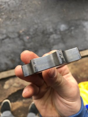

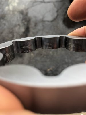

So I’m pretty sure you’ll all agree that these gears should be replaced but I figured I’d just get a second opinion before I spend another $400 on billet gears. Looks like a little contamination got into the pump and put a little scoring on the teethe the rest of the gears look fine. Let me know what you guys think.

I would 100% replace those gears. It sucks to have to spend the money, but its cheaper than rebuilding the whole engine down the road if they fail.

Yeah I hear you, I don’t want any issue after putting this thing back together AGAIN, might as well just bight the bullet.
