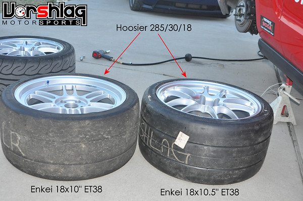

... it will be 18x10.5's weighing in at around 21lbs each. I could go with the Nurburgrings in 18x10.5 but the look is so overplayed on the S197 chassis that it is really not my preferred look. When it was the only light weight rotary forged wheel TSW offered I was content but now that the Interlagos is out and weighs a fifth of a pound lighter and is the same price and is different from the 90 billion S197's with the "SVE Drift" wheels it is more attractive to go that route.
18x10.5" wheels? Hmm.... why that size, I wonder? None of the off the shelf 1-piece 18x10.5" wheels fit the S197 chassis, front and back. That sized wheel will definitely need different front and rear offsets to fit under stock fender contours.
18x10.5" ET30 wheels from Enkei.

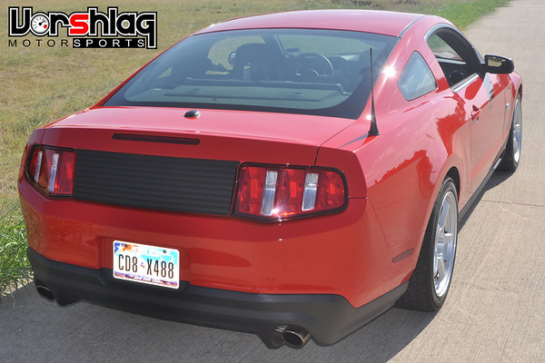

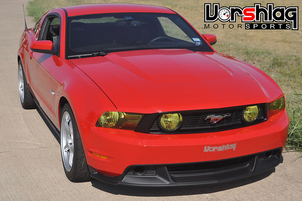

There are many 18x10.5" ET30-ET38 wheels that are made in the 5x114.3mm PCD, which will bolt onto a Mustang. These wheels all fit great up front...
But poke out past the fenders in the rear...
That is from an STU prepped then ESP prepped 2006 GT, back in 2009-2010.
We've tested all of the available, lightweight, off-the-shelf 18x10" and 18x10.5" wheels and many would fit one end of the car but not the other. Even our custom made run of 18x10" ET43 wheels barely fits both ends of these S197 cars; it is tucked inboard up front and pushed out about as far as you can out back. For a 295mm or wider tire we sometimes run a 5mm spacer up front, if the struts are in the way on the inside.
These 3 pictures above are with our D-Force 18x10" ET43 wheel and a 285/30/18 Yokohama AD08 "STU" tire
That 18x10" wheel is just the width limit of what fits both ends of these cars, unfortunately. An 18x10.5" isn't in that range. There are tons of S197 autocrossers that insist that these 18x10.5" wheels actually fit, and they keep using them, but the rears always "poke". If you corner hard enough, and have a low enough ride height, it will rub and/or cut the rear tires on the outer fender.
Some folks will compensate by raising the rear ride height. The car above has 1000# front, 600# rear springs to make it work. And the car is fast like that, in ESP class (took 2nd at the 2012 Solo Nats), but that is way too much spring rate for an STU car/street tire, and is absolutely horrific for street driving.
Of course if you can deal with differing offsets front and rear you can get wheels made that actually fit this car in 11" widths. That's how we fit the 18x12" rear and 18x11" fronts above with 315mm rubber. Yes, Forgestar F14 is the way to go: 18x11 or 18x12" is $350, 18x10" is $340; built to order, available in 2-4 weeks, machined to your custom offsets/bolt circle right in California, and coated to your choice of 12+ colors and finish options (gloss, flat, textured, brushed).
For a bit less coin and a bit less weight, our D-Force 18x10" wheel is $309/each. It would also work well with a 285mm tire, and won't poke.
Honestly, for the best competitive set-up with a 285mm tire in STU (285/35/18 Hankook RS-3 would be my first tire to test) I'd want to stretch that bi-atch out on as wide of a wheel as I could: an 18x11" seems ideal. Here's some background...
When we ran STU in 2008 in an '08 EVO X MR, we ran half the season on 18x10.5" Enkies with a 265/35/18 Yokohama AD07. We were waiting for the new (at the time) AD08 to arrive in the 245/40/18 size we needed. This 265mm tire worked SO WELL on the 10.5" wheel, in both autocross and track conditions. It just happened to be a tire we had left over from running STU in my BMW in the 2007 season, and the wheels fit that car so well, that we stretched the 265 onto the 10.5". It was incredible.
We finally got the 245mm AD08s late in the season and still ran them on an 18x10" wheel front and back (and they had different offsets to both clear the brakes and fit the track, front and rear). This EVO X was unfortunately too heavy (3350 lbs) and too powerful (it made 380 whp in STU trim) for a skinny 245mm tire, so it would overheat the tires quickly in a typical autocross run, even with the 245mm stretched to the max. Then the whiz-bang, electronicly shifted DSG transmission started to fail and the car became a big hot mess. But I digress...
My point is this: for a 285/35/18 tire in STU autocrossing I'd go to an 18x11" wheel that actually fit the car first, and if not that, at least go to an 18x10" wheel that fit the car, before I'd use an 18x10.5" wheel that unnecessarily widened the rear track and allowed the tires to rub the rear fenders. Don't use a wheel just because it is cheap and you saw somebody else use it. Also, IGNORE ALL STYLING CONSIDERATIONS, as these things don't make you faster, usually the opposite is true. Get the wheel that fits, is light, and you can afford... if it looks great, that's just a bonus. :beerdrink:
