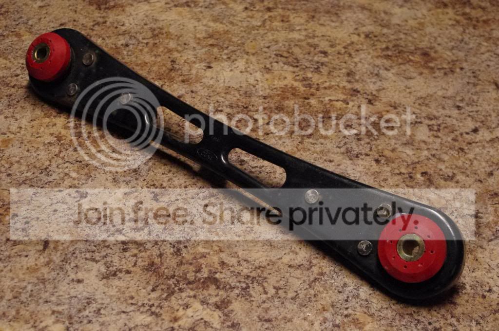

-Modified stock lower control arms with Modified Prothane Poly Bushings
-Hankook RS3's in 265/40/18 at 36 PSI front and rear
-Enkei PF01 in 18x9 ET45

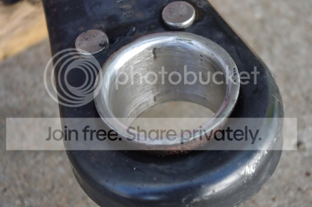

If you can't tell the changes, they are the addition of the Strano 25mm rear swaybar in the middle position, the moving of the front sway bar to the full stiff position and the addition of some modified rear lower control arms with Prothane Poly Bushings.

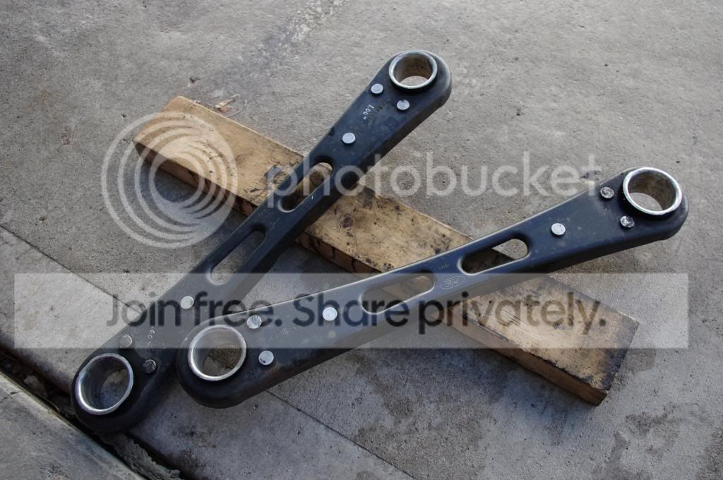

The process was quite laborious to make the modifications... it involved flames, lots of them, and a hammer, and a drill and maybe even a dremel!
The final product turned out quite nice:

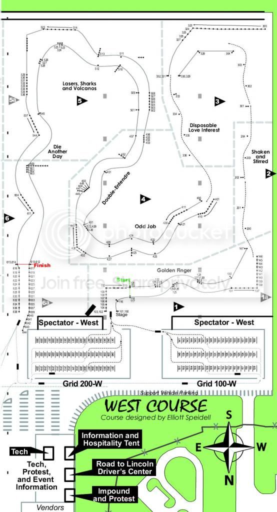

The course will look familiar to those who payed attention to the Nationals update as it is the West Course from Nationals this year. The perfect opportunity to see if any impact was made on the driver mod front and on the car prep front!
The course:
The course was completely unchanged from Nationals... same cone markers and the whole nine yards so this would be a good measure in the land of could have, should have, would have, what the changes to the car would have done for me at Nationals and there would also be fun runs! Of course the advantage of fun runs means that I can get the resident aliens to drive the car and get their opinion too! Tons of win to be had in this event!

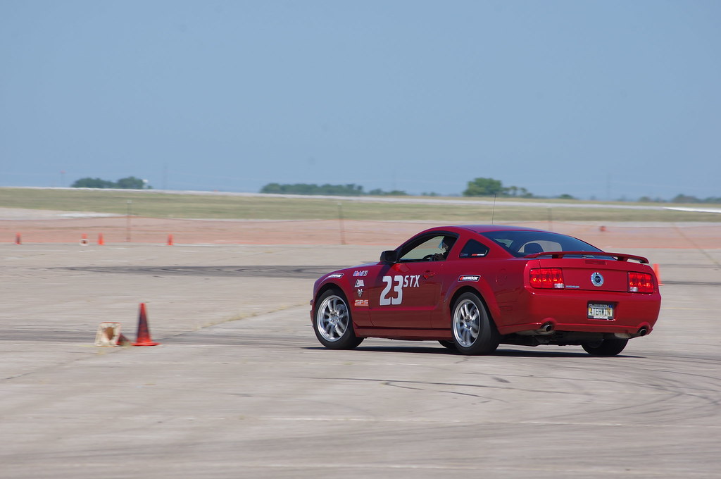

Enjoy a photo from nationals since there wont be any photos from this event:
To add to that, I had our resident alien drive my car during the fun runs... I figured since he won CSP at Nationals he'd be a worth while driver to show me how it's done! ;) And show he did! He managed to pull two back to back 58.5XX second runs... He even said he made a few mistakes and made a recommendation for a little less rear swaybar or something that would preserve the turn in but allow better power down. Not a horrible run, consistent with cars in the 20-30 positions. Who knows what advantages he could have taken with the added power over other cars in the class on Sam's course. We probably will never know since this car may never run that course in STX trim again let alone in similar conditions. It is ALREADY a stretch to compare times from today to Nationals in September so it's nothing more than a mental exercise!
That said I now have the "data" necessary to keep this balance in the car, and there is sufficient "room" to alter the car tighter, both through RC height adjustments and swaybar adjustments if necessary. I should also be able to take this information and get newer spring rates too if time permits. Unfortunately though... My brand new GoPro Hero 3 Black Edition decided it would "eat" its fully charged battery after being shut off, Wi-Fi off after getting it "setup"... Horray... I guess I'll just pull the damn battery from now on and maybe get some aftermarket ones such as the WASABI ones. Anyone used them? I was hoping to recreate my front and rear suspension videos in an autocross setting to which I obviously failed at because of the dead battery...

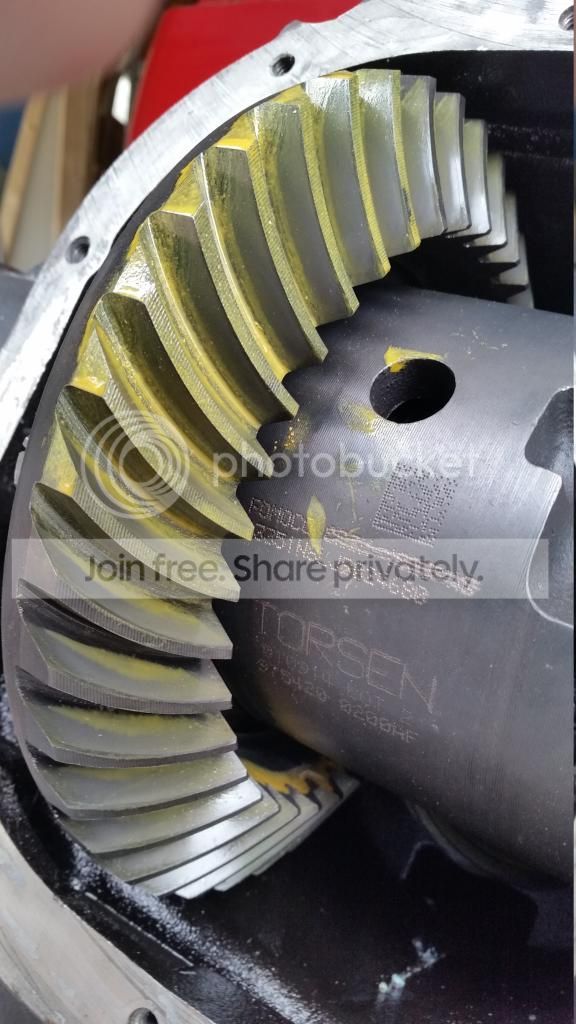

So lets talk about the run up to this event. Best laid plans and all that. I had purchased the following items from Jay at Hypermotive:
Torsen T2R

The install of this was supposed to take place on Tuesday, be painless, and be DONE on Tuesday evening so I could make sure things had a chance to get a brief wear in pattern before beating the piss out of new gears while autocrossing. I started to tear everything apart and it took me four hours to drop the rear axle out from under the car. I started checking the factory stuff... factory backlash at .019" an inch. FOR the RECORD Ford's spec is .008"-.012" so that number was waaaaaaaay off and explained some of the driveline clunking I've experienced since owning the car. The wear pattern on the gears was good though so it was "out" but still good according to Ford anyway.
The stock diff clutch packs... well... there was no break away torque at all. I haven't pulled the S-Spring and looked at the clutch packs but I'm sure they will "look" fine. Sadly for the T-lok a few thousandths worth of wear is enough to make the entire unit stop working correctly and the clutch pack material is still very much intact. You can bandaid it with alternative shim stacks or frequent rebuilds but nothing quite like replacing it with units that don't suck. So why the T2R? Well, you obviously know why, torque biasing diffs don't wear out as fast (some claim never but that couldn't possibly be true), the ability to put power down while cornering and the proven track record.
Sooooooooo... back to the install. First pinion gear shim goes on using the "Math" method involving a bunch of measuring with a caliper. Lets just say the pattern that resulted wasn't that good. Ford says a thicker pinion shim required. Now at this time I didn't have the factory shim pulled from the stock gear set. In hind sight this would have been a damn good idea. Ford even recommends that, heavily, especially given the gear ratio, Ford Racing (made to "exact" specs) gears and a Ford 8.8 housing. I was speaking with a local guy who has done these installs for his livings, several of which he set up for racing. He said he would have ran the pattern, only when we went to remove the pinion bearing the bearing came apart. Just my luck.
A little off for my taste...
I tried tracking down a replacement bearing which matched the part number that Ford Racing gave me. I found one, in Lincoln, last one in the state supposedly. My landlord was kind enough to let me borrow his vehicle. Thankfully I had the foresight to burn all of my comped time to have Saturday off so I drove all the way to Lincoln, paid $115 for this new bearing and drove home. Get all the way home and go to put the axle back together and it's the wrong bearing... The race for this supposed "Shelby GT500 high torque bearing" is about a half inch larger in diameter and doesn't go in the factory hole! Horray!
The panic nearly set fully in as I called the local parts stores and thankfully the local NAPA had the bearing and race in stock. I pulled the bearing off the stock 3.55 pinion and pulled the shim. The stock shim measured .025", the shim I calculated was .014"... Given that the factory bearing and race was different than the one that was in the install kit I didn't think this was terribly odd. Well the NAPA bearing and race was the same as the factory bearing and race so I reused the stock shim. In hindsight, I should have started there from the get go but what ever. I got everything reinstalled. Pinion bearing preload was at 22in*lbs of rotational resistance which is on the high end of the specs for new bearings. Initially the backlash came out at .011" and the pattern showed a little high and just a touch off center. Ford said that by decreasing the backlash the pattern will move down on the gears and in the direction the pattern needed to go. It would have been fine at .011" but since I'm not going to leave well enough alone I did some shim swapping to get my backlash down to .008" which is the tightest for recommends. I rechecked the pattern and it came out perfect! :) Horray! Install this bitch so I can go out for a test drive. I managed to get everything installed by about 11:30PM. I went for a test drive and put about 40 miles on the new gears. Everything is quiet, well ok, there is bearing noise but that was there from the factory too and the torque arm doesn't exactly hide those noises very well, nor would an aftermarket UCA for that matter.

Now for the event, the part you all were actually reading this post for right? Or have you all given up on me! :) As is the "tradition" with the Nebraska Region we run a course from Nationals, usually the west course (less fence to setup) and this was no different.
Course map for those who are not familiar:
Basically your typical speed maintenance course with a healthy dose of "what the fuck?" at the end. In the end it was a great course up until the last about 5 seconds which was just pure unadultured rape of your fun. Lots of places to lose speed, lots to gain speed and places to carry a lot more speed than you thought. Lets go through an overview of what is on the car right now though:
