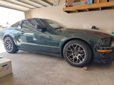

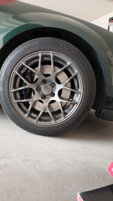

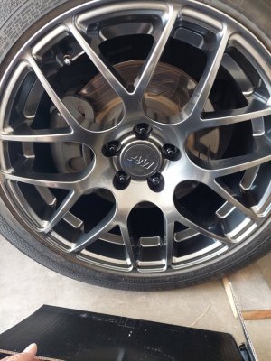

I did see them at American Muscle and purchased them as well. Hopefully in a couple of days I will install them, here is a pic of the rims. According to American Muscle, these brakes should clear the rims

And I can confirm the 18x9 AM FR500 wheels also clear.
I got a set for the 94-04, but same specs as 05&up.

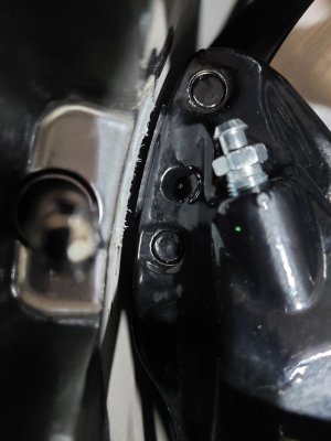

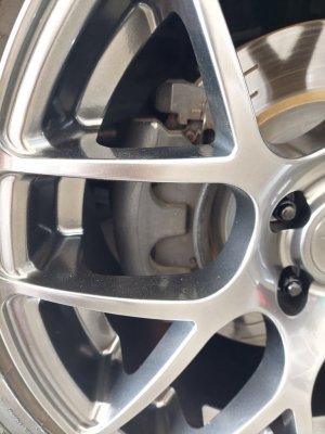

The weights did grace the caliper though. There is probably 1/8 of an inch of clearance. Going to be taking the rims to get then re-balanced and ask them if they could put the weights elsewhere.

Have them "static" balanced. Weights are only put on the inside lip. Unless you want weights on the face of the wheel.
Ps: I have my own spin balancer. And I dont zero out my wheels anymore. I kept losing the stick on weights at track days. Only use the static option and only if the wheel is significantly out of balance. Anything under 3/4 oz out is perfectly fine. I get no vibrations on the highway or at up to 145 mph.
Im not recomending this, just posting personal exprience.

The weights did grace the caliper though. There is probably between 1/8 of an inch of clearance. Going to be taking the rims to get then re-balanced and ask them if they could put the weights elsewhere.
Not sure if these are any thinner.
https://www.amazon.com/CK-Auto-Profile-Adhesive-Weights/dp/B07K2R9CXJ?th=1
I just bought a used Hunter road force balancer, and it has a mode to do "split weights", to line up with the spokes only (or even inside "hollow" spokes). Looks like you could move your weights outboard if they could be moved to spokes, yes?
If they can't get inner "dataset" arm (used to automatically tell the machine where weights go, once you put arm in the spot you want "inside" rim), you cam measure from inner edge of rim, to spot in/on "spoke", and manually enter info in machine. It needs to know how far outboard from inner edge of rim, and a theoretical diameter of where wheel weight will be placed.

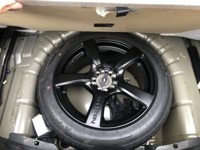

Don’t forget to swap out your spare wheel for a full size. The stock spare won’t fit over the Brembo.

Shit, no clue if my stock spare even fits. Have NO spare in the fox body. LOL Cars are not a daily anymore, I only have that shit in the 07 to keep the trunk floor supported.
