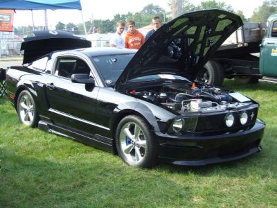

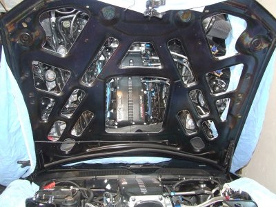

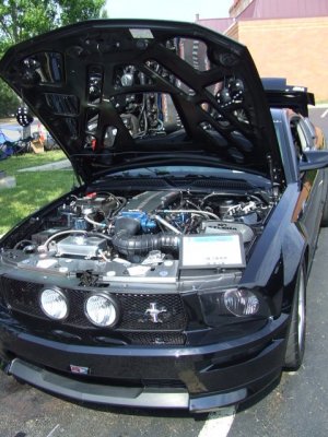

WMS Hoodliner (notice the engine cover is off)
Hood off car:
Me masking:
Mat glued down before cleanup of excess glue around edges. To clean it up you need Goo-Gone or anything or that sort:
Installed back on the car:
