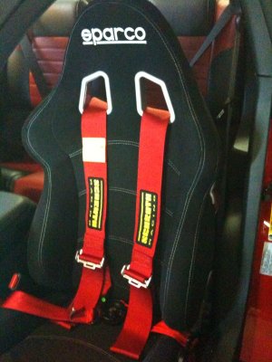

I am using Sparcos as well. What I like about them besides marvelous support in corners is the reclining ability with memory. I can occasionally safely drive my children to kinder garden :)
Jan
