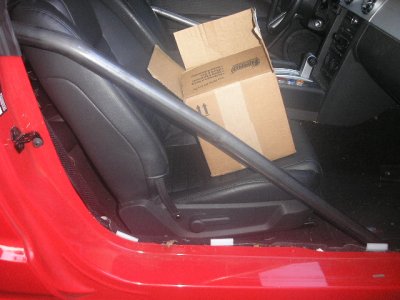

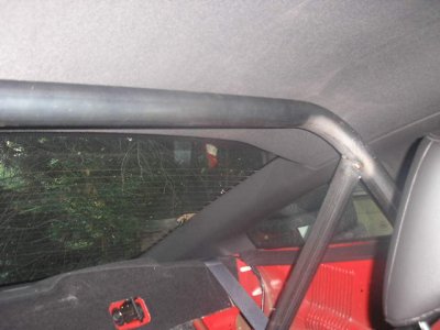

here's a couple pics. it's not so much as the CE swingouts are poor quality i just don't like the way they tell you to install them so i'm just going to use them as anchors and make the bars removable but not swing outs. the only thing i really care about is being able to pull out the seats and work on things inside if need be.

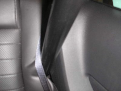

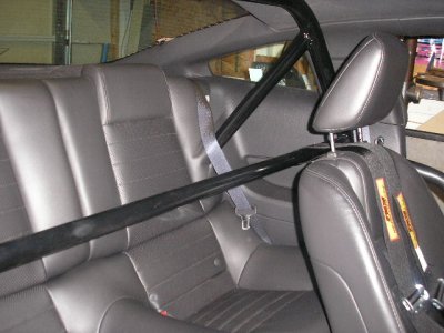

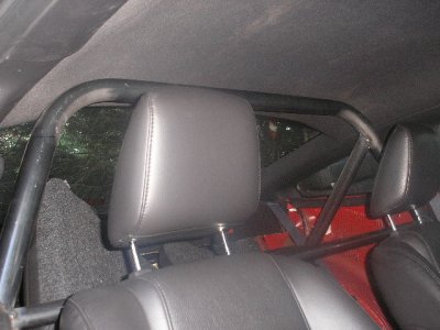

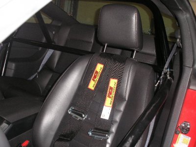

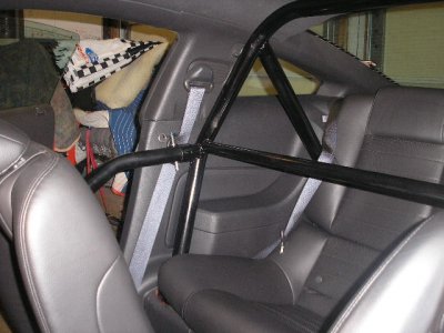

all done last weekend and got the seat belts installed carpet and back seat in this week. ready to race. i didn't tig weld it cause i got impatient i just want to race now that the weather is getting nice here....gonna be around 60degrees sat night :) guess the f'n seats are coming right back out again:crazy:
looks killer man !
