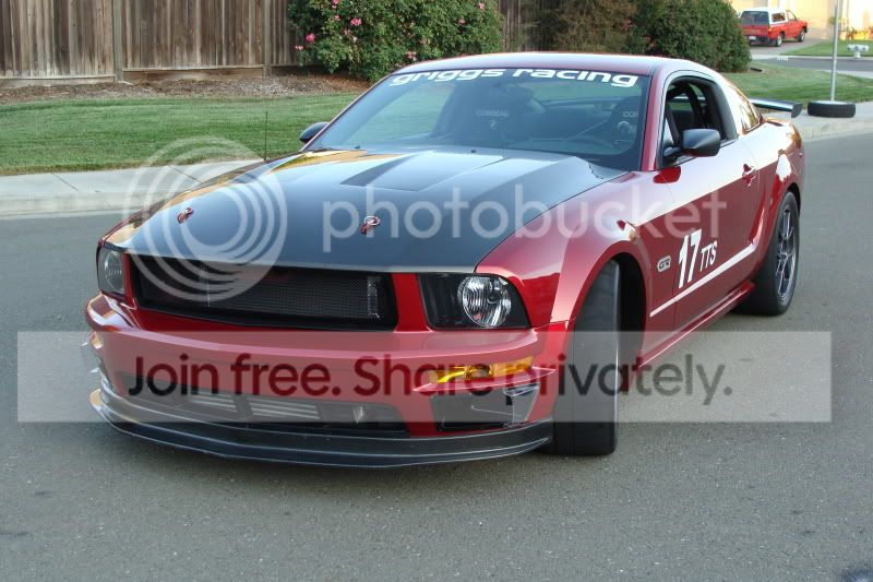

A few years back I bought my 2006 with motorsports in mind.
NOW mind you i don't write novels well, i'm not a 18 year old single kid that has time/desire to photograph their car endlessly and spend countless time on the net chatting about there ride.
But i do hope..that sharing this build will help a few people and maybe help me build a better car.
I've swaped out a few suspensions..tried a few different engine tuners..ran a few track with the car.
Thanks
First pic of the car....STOCK
Its been a long trip so far

Wow... Griggs = massive erection... lol.
Is that the TT, ST, or RT? or just a collection of griggs suspension/body parts?
Oh, and small request for more pics of your car... I need a new background and that car looks fucking sick man!! :beer:
The cars currently a Griggs installed ST chasis car with a Griggs tuned engine that makes 450-485 RWHP.
..Also equipped with many other parts some of which you see..some not :)
I'll continue my story when i have some more time..as the cars has a few different phases/suspensions
As far as the background...its by my house and easy to take pics...I know its not the best place
Regards

What rims are those. Full specs please (size, offset) :),
Your car looks great!
Well maybe just a few different angles lol, I don't wanna make you go find some ridiculous back drop just for me. haha. I don't care too much about the background, the house is cool man. But wow, that's an amazing set up there. :thumb:
and dan, I'm not sure the brand, but DusterRT had the same wheels and they're 18lbs each and 18X9 IIRC. not sure on offset or backspacing though.

Where did you get your hood @ front grill at !
Thanks !
marksti
Aug 8, 2009
269
Thanks !
The hoods a VIS heat extractor got it at cruizen concepts (beware that i had to install hood pins right quick..and also the rear lifts at high speeds..If i had to do it again i would do a viper style hood with vents in the rear to drop underhood pressures at high speeds,)
The grills the new one from Shelby
