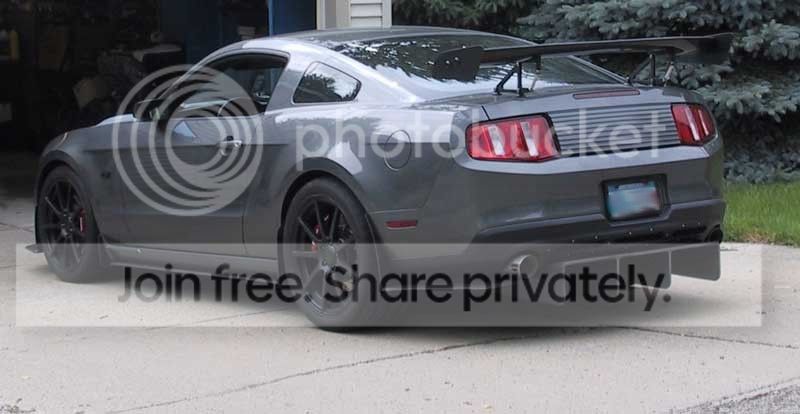

Is dumping the exhaust under the car going to negatively affect the high speed/low pressure air flow you are looking for by adding the aero?
Department Of Boost
Alpha Geek
May 26, 2010
8,809
28
Nope, it's so I can build the diffuser how I want to.:thumb2:
And it saves weight.
It's less complex and easier to work on.
It won't rattle/knock if its not there either.

I'm digging it. I'm trying to figure out how to put one together around the GT500 Mufflers. That is probably the way to go.
Department Of Boost
Alpha Geek
May 26, 2010
8,809
28
This car was switched from GT500 mufflers to Pype Bombs (and M80's mid mounted) to make it possible:
