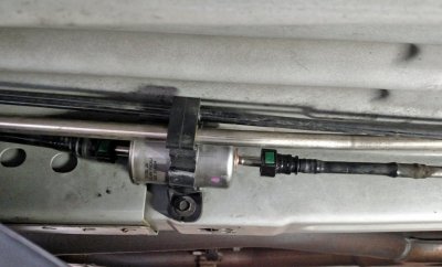

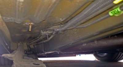

What do they use for a fuel filter?
Just the one in the tank.
The lines that would normally have the fuel filter mounted in-line are just lines, no filter:
On my wife's '08 GT500, there's a filter there:
bujeezus
Aug 31, 2015
3,253
356
Alabama
That just doesn't make any sense. Mine is like your wife's car. Easy peasy.
Gabe
Whippled Coyote
Aug 7, 2011
8,471
1,570
Yeah I hate "lifetime" filters/fluids.
That's idiotic.
But it lets them advertise a lower maintenance cost for the car.
It's all about marketing and sales.
