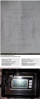

Had this car back out tonight. Only new stuff was 17" RT-S/M&H fronts, removed front swaybar, and continued work on the calibration. Went pretty well. This single disk lockup clutch converter just isn't enough, it won't fully lock so I can't get the MPH out of this car that I usually can. Air got better after this, was down to 250' by 11PM, but this POS track we have gets huge bald spots and they make zero effort to fix them. Hell the scoreboards never worked all night. Really sucks, we rarely get 250' air and it certainly never happens in May, then can't even get a track to take advantage of it.

Here are 11.55 and 11.52 passes. I see a little side to side jerk while leaving on the 2nd pass, so only 1500 miles and 10 or so dragstrip passes and the differential clutches are already going to hell. This car will run 40s if it's ever on a decent track with reasonable air. Suspension looks pretty neutral, I expect he'll be leaving that alone. He does have all the parts to put a 3.31 gear in, that will probably be all that is ever done to this car going forward unless he changes his aversion to roll bars.
