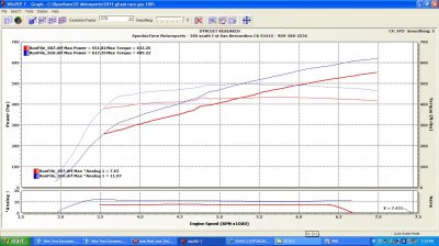

Chasis Dyno Numbers so far:
BASE PULL on the car 100% stock 347 rwhp 326 rwtq
Dyno numbers with the Kenne Bell SuperCharger
91 octane 551rwhp 433rwtq @7.6lbs boost peak -> +204rwhp +107rwtq
100 octane 617rwhp 495rwtq @11.9lbs boost peak-> +270rwhp+169rwtq
Engine flywheel horsepower with Kenne Bell supercharger.(est)
551 rwhp is 661 engine/flywheel HP
617 rwhp is 744 engine/flywheel HP
I want to add that all the knock sensor tables are STOCK and un-modified to keep the tune as safe as possible.

Just for kicks I posted a sheet changing the pullies in 1/8 in increments.
The pulley comparison was done with the same tune ,just swapping pullies. Please keep in mind we are very busy at the shop, so its better to call us @909-388-2536 than expect to see us on the site through out the day. John and Brian should be able to answer most questions. Thanks Adam
20% power train loss? a bit much isn't it? even in an auto, the stock numbers show a 16% loss, yes the blower will sap some too but that would be accounted for prior to the drive train.
I just have a continually hard time buying (from a engineering stand point - which I'm not a engineer) the the same components take 65 HP to turn, take 127 hp to turn when the power is upped. The rwhp is up 78% but the drivetrain takes 127 hp a increase of 95%.
