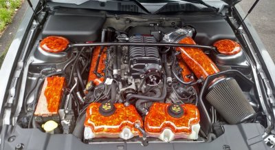

Hello fellow 'Stangers. I own a '14 GT with a Roush supercharger. Does anyone know of a strut tower brace that will work with this setup and the stock hood? Thanks.

This may well work...designed for STOCK oem hood with whipple blower. https://www.steeda.com/steeda-mustang-whipple-billet-strut-tower-brace-555-5726-whp.html

I tried the Steeda 555 5726 WHP Brace on my 2013 Stage 3, but didn't fit. The cross bar has multiple bends and appeared it would clear the hood and supercharger. However, the bar would not clear the CAI tube. I returned to Steeda and commented on their add stating it was compatible with the Roush TVS, but they didn't change the ad. I even wrote a review that was went unpublished. It's a well engineered strut brace, just not for the Roush.
ps. I saw a 2011 Mustang with a Roush TVS installed and equipped with a Steeda Brace. The cross bar was straight not with multiple bends. Owner said he had it for several years and had to bow it slightly to get to clear. So maybe some old ones are around.

I have an OEM '07-'09 GT500 strut tower brace on my Whippled '13, no clearance issues.

The issue with 99% of em is they only use the inner pair of studs of each upper strut assy. Then they also use elongated /slotted holes. There is only 26 ft lbs max on those studs.
I started with the optional 2010 GT stb.. (also used in 2011 for the V6 cars....... then again in 2012/2013 on the Boss 302). It's now called a ...'Boss 302 stb'. Once my M90 installed, it had to be removed... won't clear the CAI on driver's side...by 2".
The steeda STB's uses all 4 x studs....on both sides..... and they are very close fitting holes, not semi useless slots. CM bar uses spherical's on both ends. Threaded assy at each end...to adjust overall length. One assy is reverse threaded of course....just like a turnbuckle. RVS threaded assy can go at driver's..or pass side. Transverse bolt assy as well, at each end. This is so the stb can be lifted up at an angle.... from either side..... or removed altogether. That came in handy when swapping oem twin 55mm TB with the FRPP twin 62mm TB. Also came in handy when changing out plug #8. In both those cases, the stb was in the way...so stb was simply raised way up on driver's side.
With stb completely removed, the 4 x studs per side remain intact. They have too, otherwise the steeda adjustable camber strut mounts would go out of alignment.
One of the fellow's on the Roush Forum was run off the road by a woman on her cell phone. He runs off the rd... and nails a lamp standard..... right where the pass side strut mount is. Body shop tells him if the STB was not installed, the car woulda been a total right off. I saw the pix... a real mess... but was repaired. I look at the STB as closing off the 4th side of a rectangle.
But I also installed a FRPP control arm brace,(which actually ties the back end of the oem K frame together), BMR A arm brace,(which does tie the A arms together), and also a pair of steeda CM front sway bar braces. So 4 braces below..and the stb above. Compared to local buddy with just the control arm brace, I can tell the difference, front end feels more...'solidified'. This is on a 2010 GT coupe.
