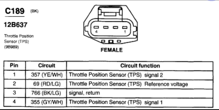

The readings I am gettle from TPS with the Throttle Body chattering
GY/WH 3.27
BL/LG .04
RD/LG 5.02
YE/WH 4.24
No variation on any moving Throttle Blades
Readings with the Throttle Actuator cable removed
GY/WH .04
BL/LG .04
RD/LG 5.02
YE/WH 4.84
Does this make any sense or help

Below is the pinout diagram.....based on your voltages I think one or both sensors in the TPS (basically potentiometers) are reading that the throttle blades are 75-85% open... Which is why you are in limp mode. The reference voltage is the 5v supply that's supposed to be there. The signal return is what goes to the PCM.
The voltage sweeps up as the throttle blades open... As discussed previously, you should see a little over 1v at idle / closed, and the voltage sweeps up as the blades open which is calculated as relative position. I'm not sure exactly how the two sensors work in these new TPS... I believe it's part of the redundancy and failsafe measures in the drive by wire system... I do know the PCM does some kind of a check between the two voltages from the sensor... Perhaps one goes up as the other goes down... Etc.

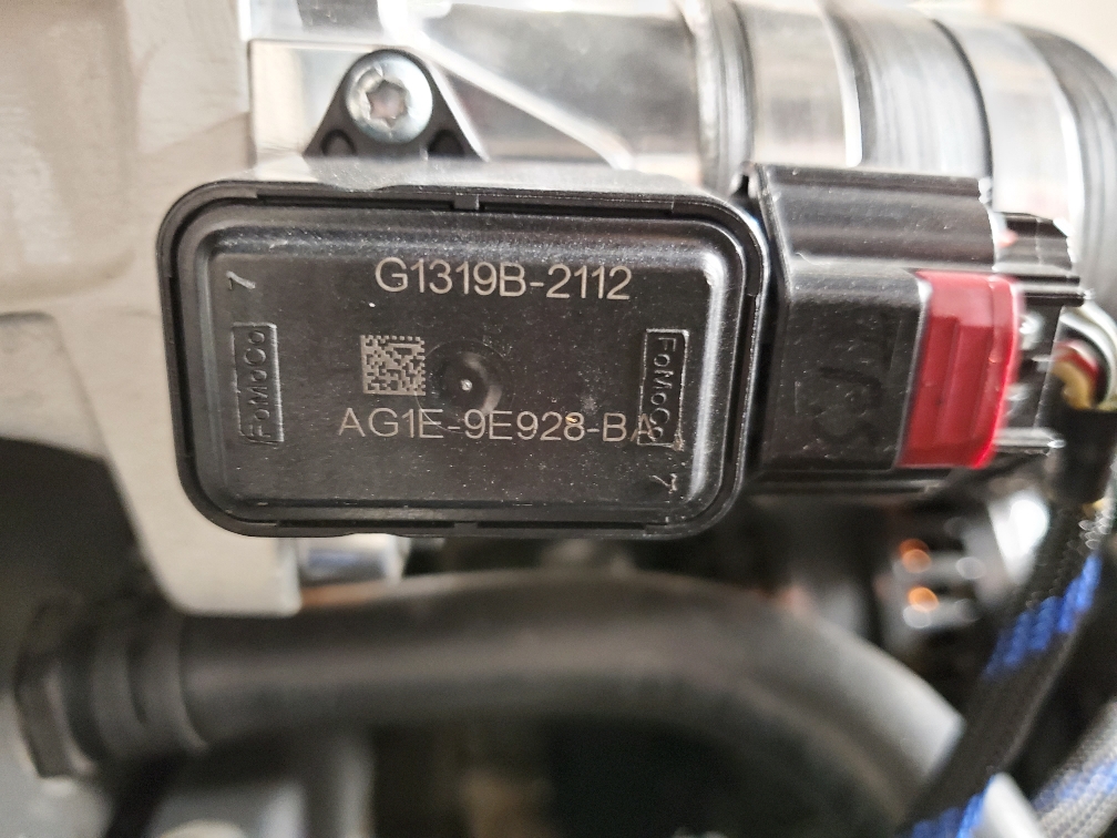

There are three different generations of TPS... I'd try a new one and do the relearn procedure... The latest one has the square / rectangular body... Picture below with part number.
