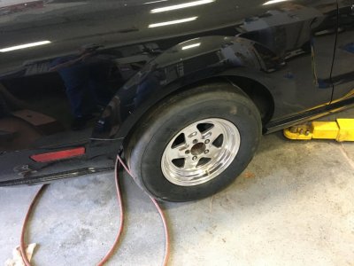

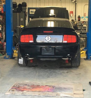

Talked to American Muscle yesterday and if it doesn't hook up after this last application I'm replacing the back wheels with new wheels and rims. The funny thing is I have four months to wait since nothing is in stock but one Bullitt 10 rim. I have the 9 inches 18-inch rim and the new tire is 305/35/18s wow I might do that for just looks alone.

Well, I had to order another set of rear rims to make them fit. I already ordered them but darn I have no patience it's going to look like a competitor it will give me something to look forward to. I'm spoiled rotten.

Will someone post pictures of their Mickeys on their s-197? My wheels have arrived and I'm excited about when and how they will look when finally mounted. Even better if you have the 305/35/18s.
18 x8 front with 235 2SPS tires and 18 X 10 rear with 305/35 R18 MT's. I use Nitto NT05R II's on the street, as MT's handle like garbage, even on dry pavement. Nitto's give up some traction, but at least have moderately good handling (for a drag radial).
