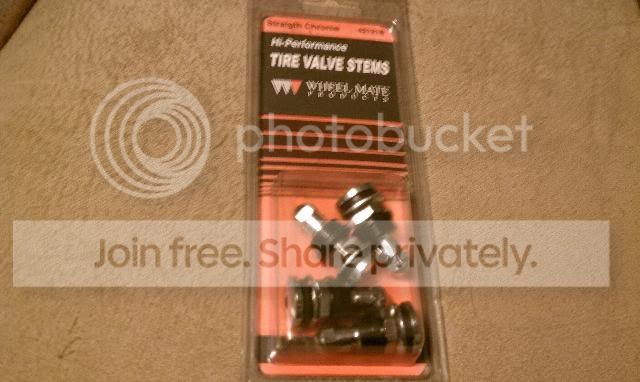

1- bolt style Schraeder valve

Start by drilling an appropriate sized hole in the 2" threaded plug for the air valve. This one worked out to be 1/2". Then install the valve in the plug.
