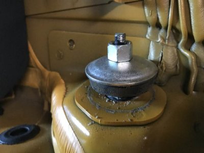

...into my 2009 GT. The problem is that when I attempt to loosen the nut holding the shock piston shaft, the shock piston shaft turns with the nut. Online Shelby instructions offer, "Using the crescent wrench hold the top of the shock piston shaft while using the 15mm wrench to unbolt the upper mounting fastener." That's of no help because a crescent wrench simply won't keep the shock piston shaft from turning when I turn the nut.
My photo below shows what I'm dealing with. When I turn the nut (indicated by the red arrow and what Shelby calls an "upper mounting fastener"), the shaft (indicated by the green arrow) also turns. Is there some sort of special Ford tool that's designed to keep the shaft from turning while also turning the nut or am I relegated to a crescent wrench? Thanks.

Cut a small piece of rubber hose... Slide it over the threads leaving a little room for the nut to back off, then use vice grips to hold the shock shaft with the rubber hose piece protecting the threads from the vice grips.
Or... Sometime an impact gun will get the nut off... But to hold the shaft you'll have to take that same rubber hose piece I mentioned above and slice it open to go around the shock shaft from inside the fender well. You might have to get a helper to grip the shock shaft with vice grips using the rubber hose to protect the shaft. I also recommend cleaning the rubber hose and shaft with brake cleaner to get ride of any slippery substances, which will aid in the rubber grabbing the shaft when pinched by the vice grips.

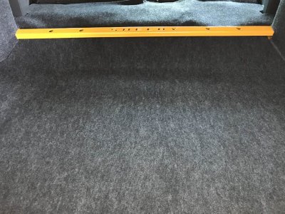

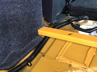

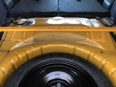

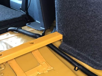

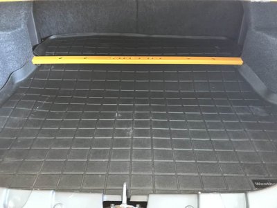

So I got the brace installed. Strangely enough, once I dropped the brace on, the shock piston shaft did not spin (at all) during tightening. This was a surprise as I'd already tried tightening the shaft (without the brace on) and they continued to spin. I don't know what effect the brace had on the shock piston shaft but regardless, once I put the shaft in place, the shaft didn't turn. Then it became an easy install.
Thanks to everyone who posted help! Even the suggestions I didn't use provided me with great ideas to help me figure this out.
Here are some pics of the install. Thanks again!
