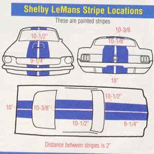

The description of the moproauto side says, the stripe is 10.2 wide on the hood and 10.1 on the roof. The original Shelby stripes were smaller on the hood and wider on the roof and at the end of the hood that if you stand in front of the car the stripes looks straight on the car.

Well you learn something every day. I never knew that but the slight differences make sense to compensate for distortion when being placed over body curves.
