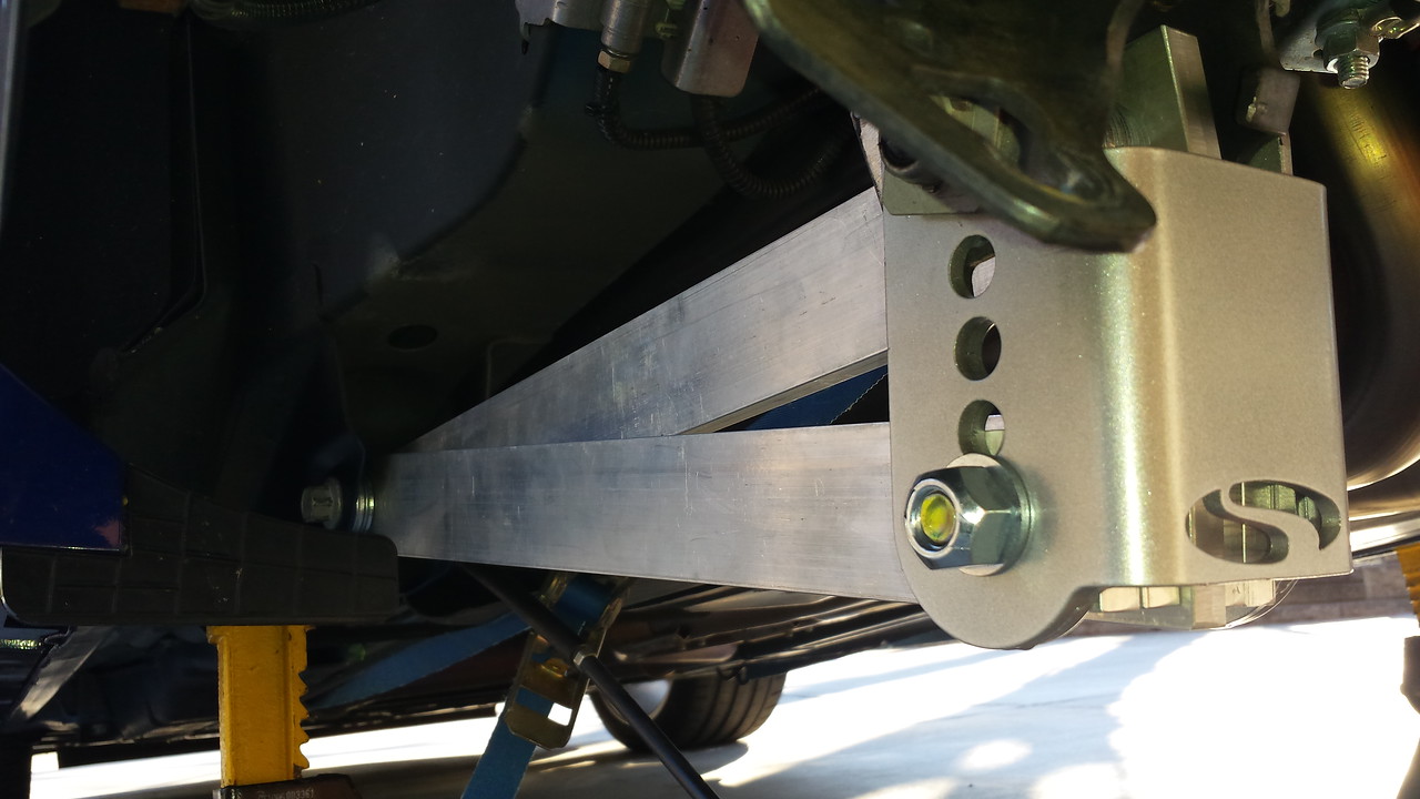

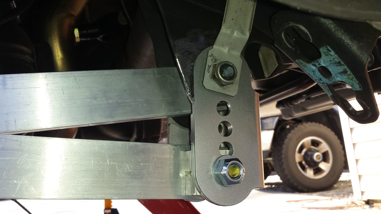

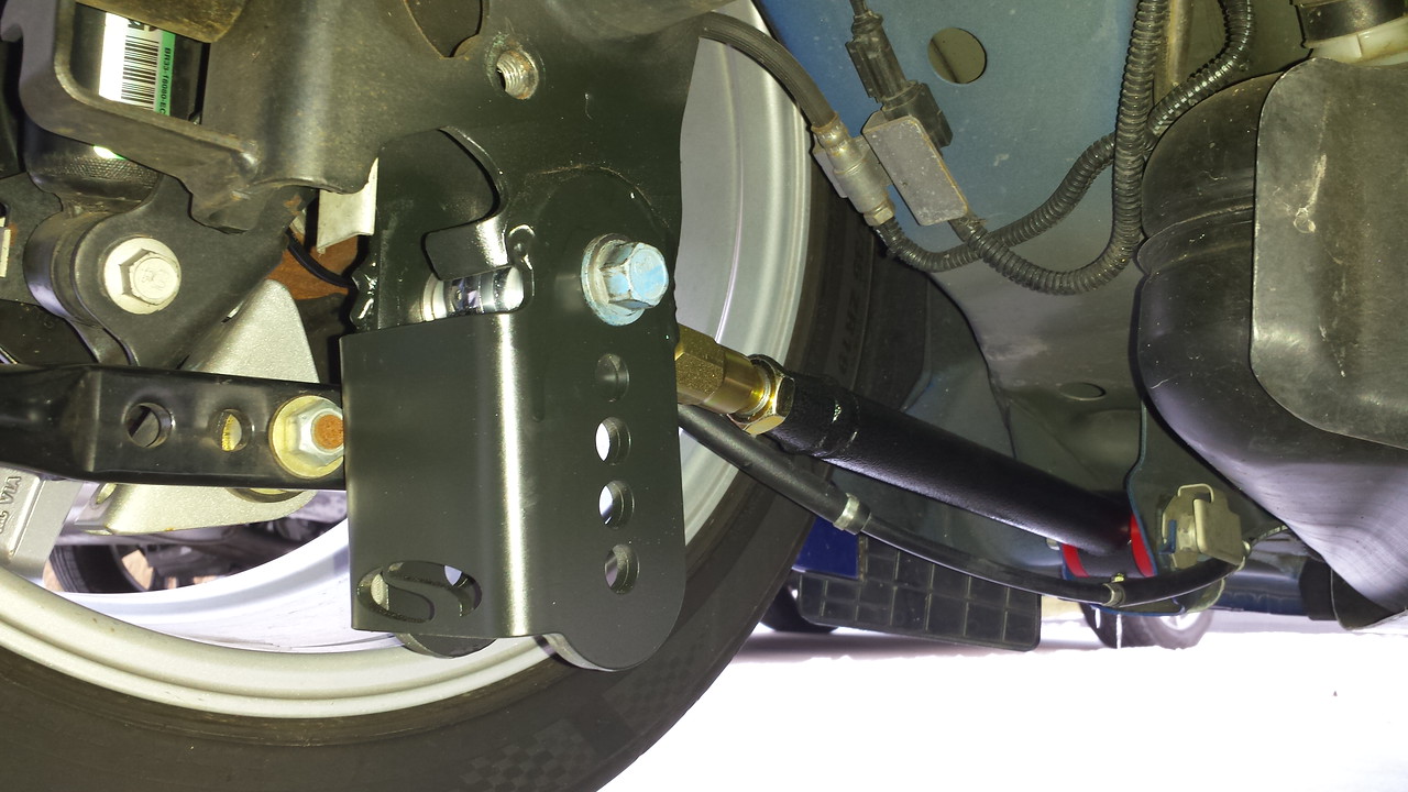

Setup a fixture to align the rear end for welding LCA relocation brackets onto the axle. After measuring both sides to known frame points to confirm the wheel base and axle was squared to the chassis, everything was tightened down at the factory ride height and then tack-welded the brackets. Removed the axle assembly and finished the welding from a better position than on my side.
Installed the BMR LCA's when the axle went back into the Mustang. Springs and shocks will be next when the weather makes it out of the teens.

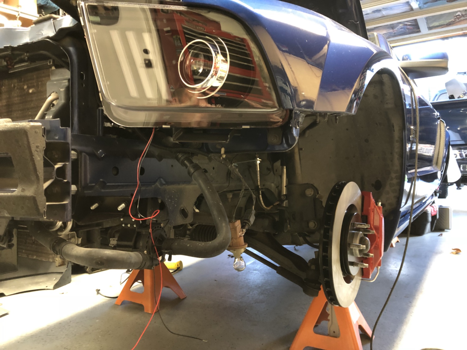

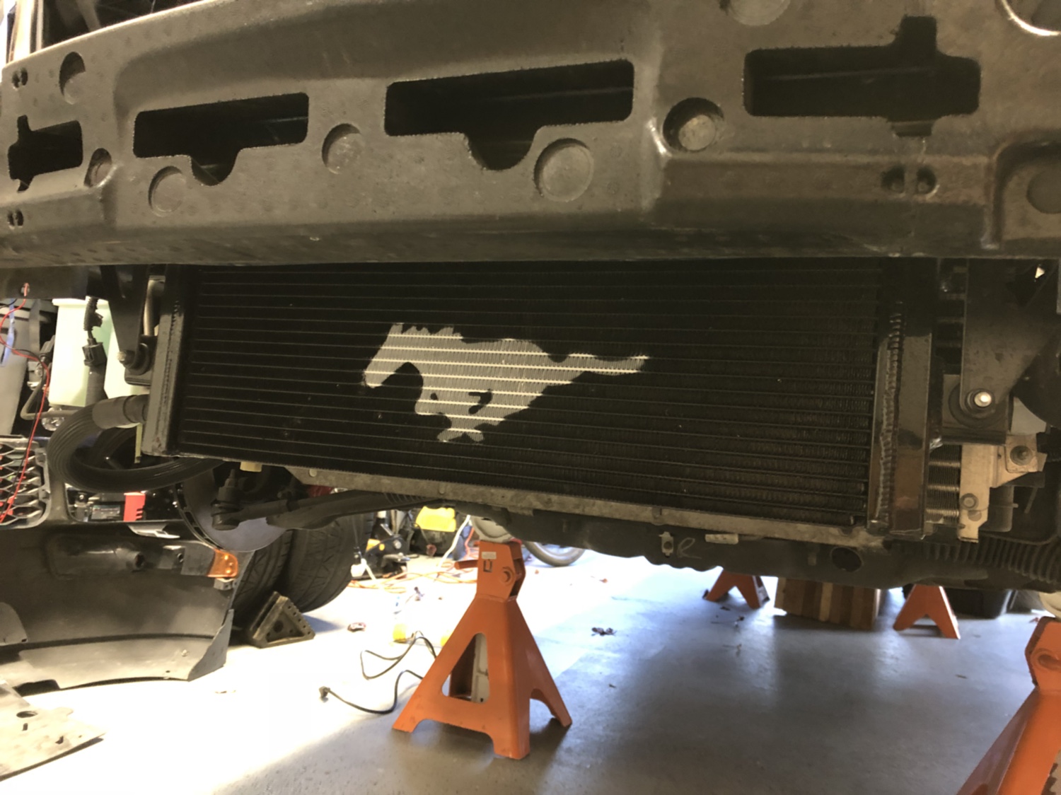

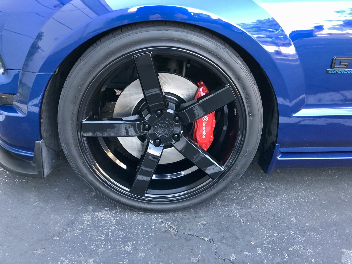

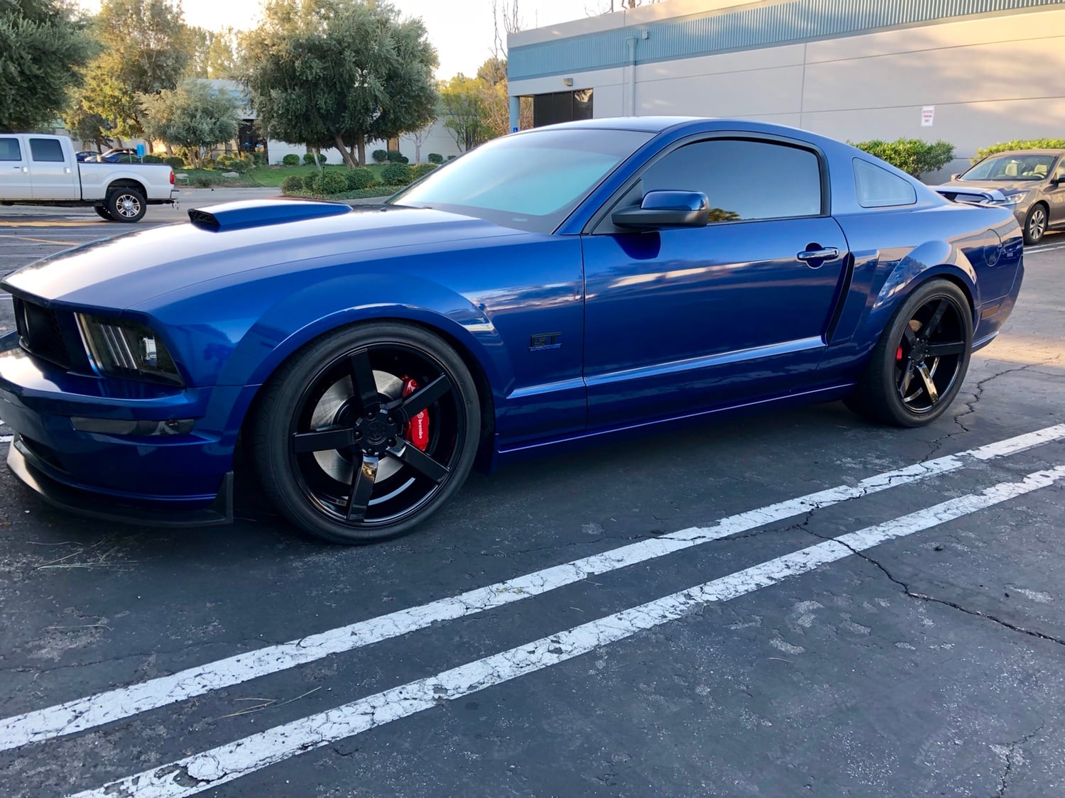

Some new parts...
Powder coated Brembo’s, new Centric rotors all around, powerstop Z26 pads and Russell stainless lines. HUGE difference! Car stops now!

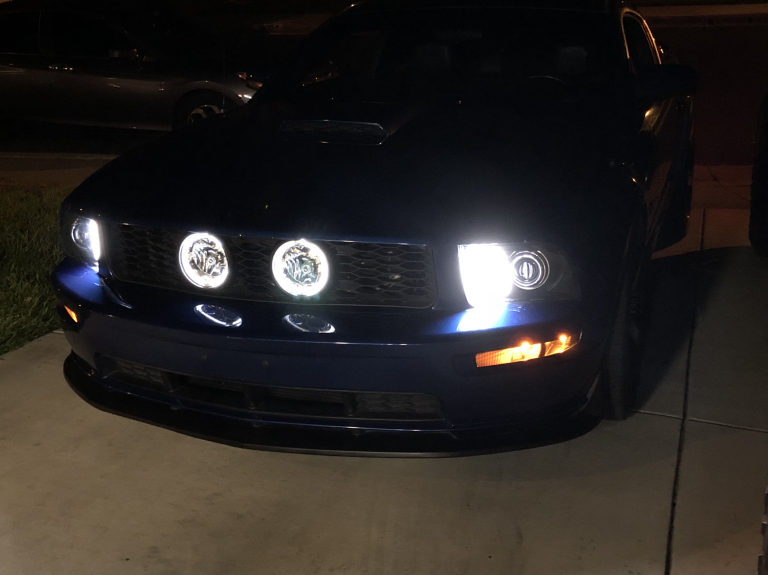

Raxiom projector headlights with LED bulbs. these are awesome, very bright! Love the look too! I wired the drl tri-bars to run when the key is on. Little expensive but I think well worth it if you drive on dark roads a lot, factory lights are horrible.
New corner marker lights. Found these on amazon cheap... I just wanted the stock amber lenses gone. These have a clear lens and blend in a lot better now.
Ford racing cut-n-clamp x pipe. Haven’t noticed any power gains, didn’t expect any... I was just looking to kill some of the drone from the flowmaster outlaws which it did a little bit, just sounds smoother now. Kind of a bitch to install in the garage with jack stands.

Nice mods jlmotox!!! I like the head lights. I have the tinted ones and I can't see anything at night. I love the look in the day time but they are dangerous at night. Thinking about changing them out and you may have just inspired me.

jlmotox That looks sharp. I hate the factory headlight as well. What Pump and HE are you using if don't mind me asking.

Thanks! The pump and HE are what came with the Whipple HO kit.
Thanks! After having been out at night on some dark roads with these lights I’m more than impressed! Wished I would’ve done them sooner!
