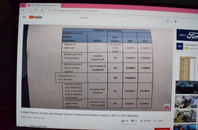

On my 2010, you hit the switch once to shut off the traction control. "advance track off". Stopped, hold the switch down for a few seconds, then it goes into ..."sport mode". Hold it down for 15 seconds..and it's completely off. In any mode, the ABS brakes are always functioning.

Interesting. On my 2010 GT you press the button once and traction control is off. To turn off advance track you stop, step on break and hold the button down for 6 seconds.

On the 2014 ….
1 press = Traction Control Off
2 presses (double click like a mouse) = Sport Mode
Hold button down for 4-seconds while pressing foot brake & clutch pedal
Completely disables Advancetrac
SilBult
May 15, 2019
27
8
I have a '14 GT and do the occasional autocross. I haven't found any need to depress the clutch pedal in order to disable the advance track. You do have to push down on the brake pedal and hold the button down for few seconds until the "advance track off" appears in the message center.

This above is correct. I had it wrong on post #4. BUT, to get into sport mode, I have to be stopped, with foot on brake, then double click. To completely disable advancetrac, again, stopped, with foot on brake (10 secs on my 2010 auto).
