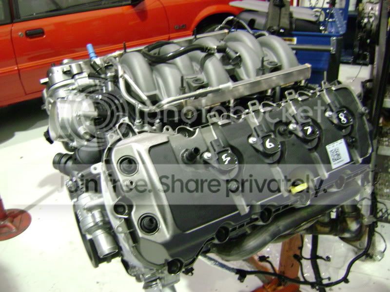

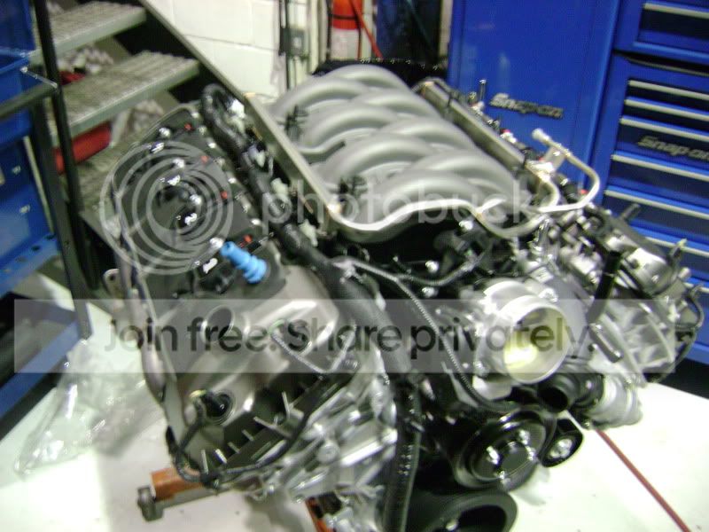

Ok.... So I wake up this morning and grab my double double like always. On the way to the shop I thought "hey let's get the valve covers back on the 5.0 and go from there"

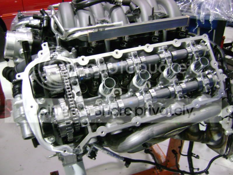

Almost forgot to take a shot of the cams while the covers were off :p
Took the tape off, put the gaskets back in and bolted the Valve covers back on.
Coil packs all back in, put the harness's back on, Slapped the coil pack covers on along with the intake cover to take a look.

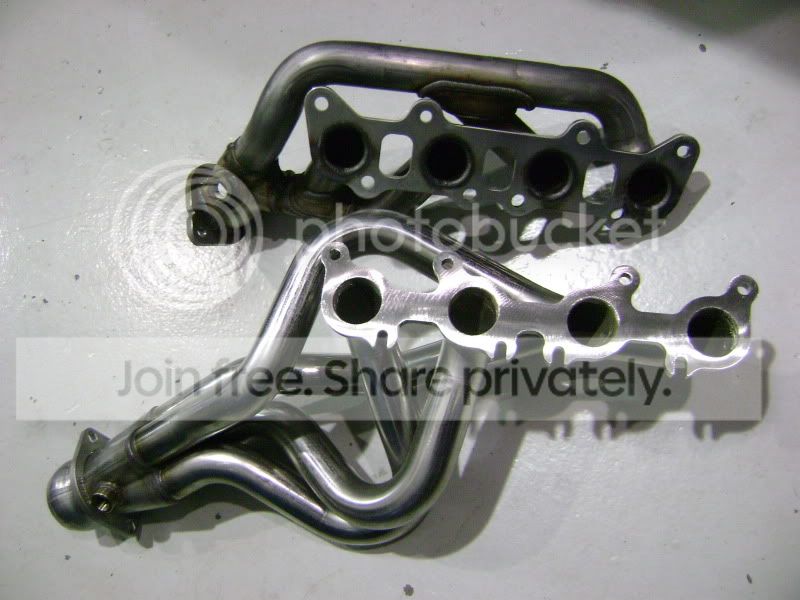

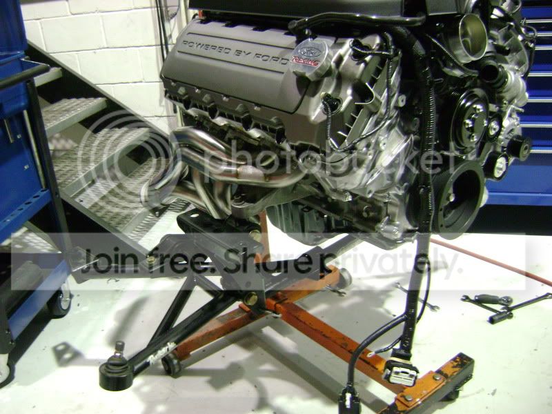

Time for some Jam :p Kooks 1 3/4 long tubes. They even say "Coyete" laser engraved on the flanges.
Comparision to stock header

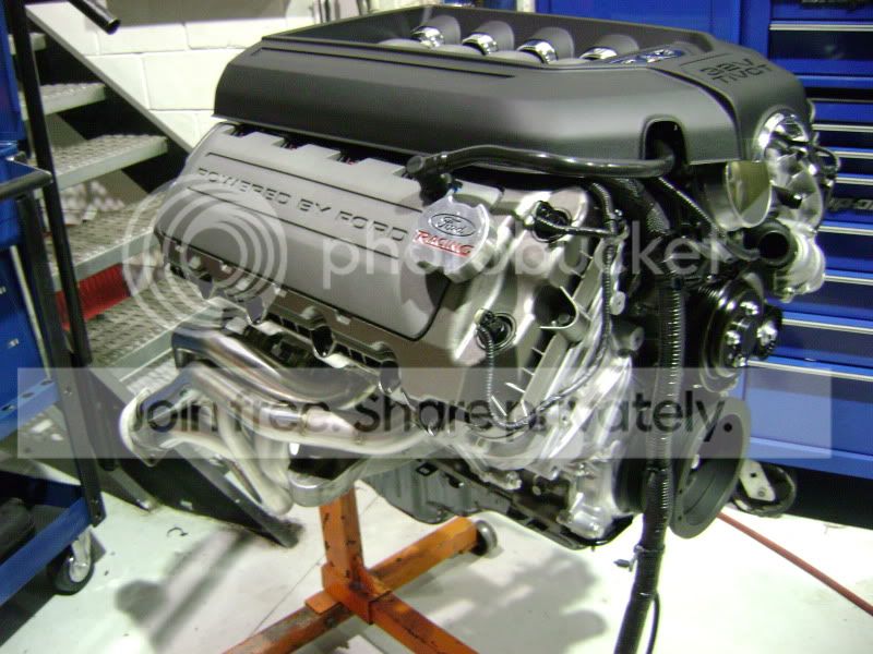

I keep the original beefy header studs and stock gaskets. Always throw some copper sealer on for good measure. Also put the heat tape deal back on each cover. ( I slowly peeled them off before paint and stuck them back on with out problems)
BAM :omfg: Bolted the motor mounts off my old 3 valve motor onto the new 5.0 with no issues what so ever :) The headers fit like a dream of course and I didn't have to even cut any of the factory header studs. Also put on my ford racing oil cap :p

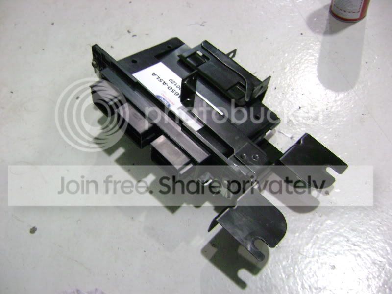

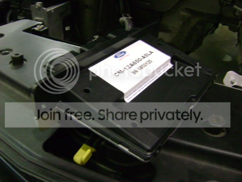

So I unwrapped the new computer that came in my control kit. Part number on the side had the computer code on the other.

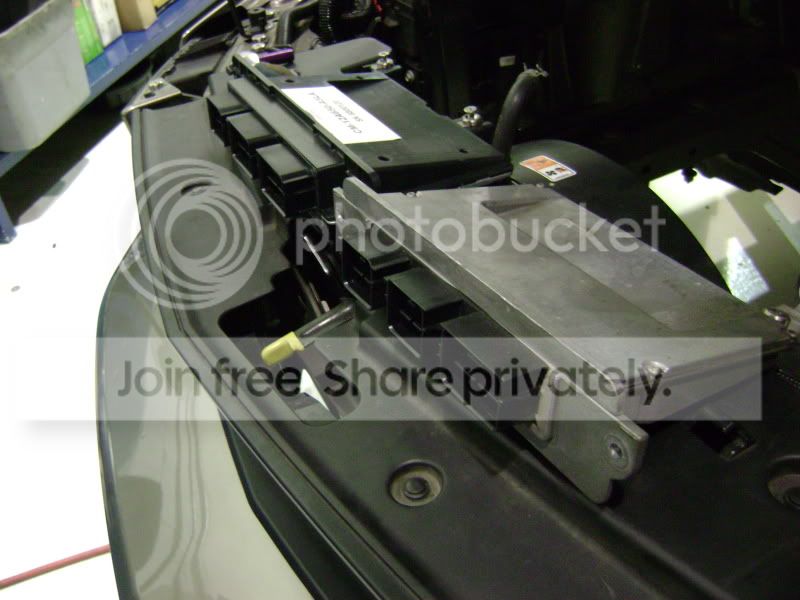

New and old computer side by side, New computer weighing in at .5 lbs less because it's half plastic :roflmao: Removed the computer bracket aswell, cleaned all the dirt that was there.
New computer slides right back into place no issues.

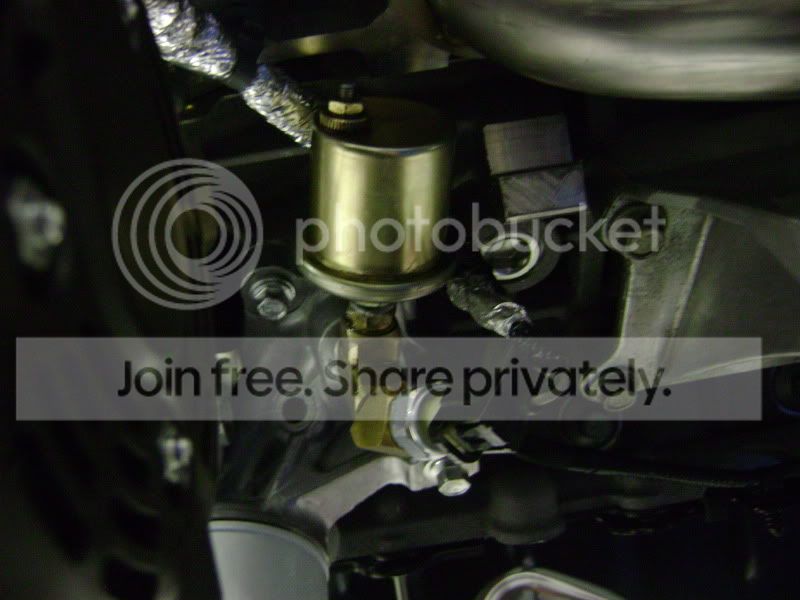

Took my fittings / Autometer oil sending unit off the old motor and installed it on the 5.0. (used for the oil pressure gauge) Still keeping the stock sensor working aswell.

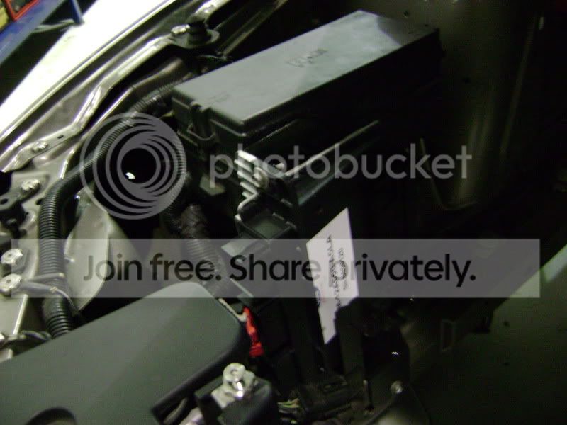

The Alternator kit didn't come with the wire....... Unfortently it's way further then before. I called ford to just buy a new 2011 one to save the trouble thinking it might only be $20... but apparently you have to buy the whole harness netting over $200 -_- so I removed it off the old motor, had to drill the tab out a bit to fit and grab a new nut. Thr connector is the exact same the only thing needed is to be extended (not shown here)

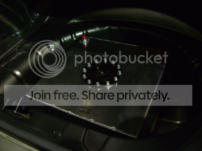

Ok so now after I was all fired up, I went back to the rear and got back onto the fuel system. Grabbed my -8 Straight, -8 Cap and -8 45 degree, & -10 to -8 reducer (off the filter) with my classic line and made it happen
Pic from up top showing how the cell sits inside

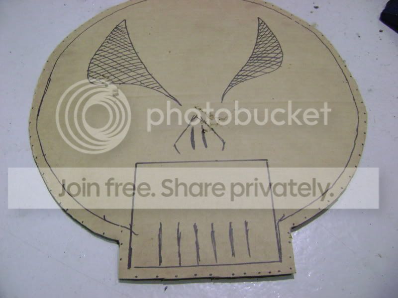

Ok.. so like I mentioned earlier in the thread, I want to make an alum piece to clean up the look under the rear of the car. Grabbed some card board and slapped it in the trunk. Raised the car and with a marker traced out the shape I had already cut.
Me and Rob were joking around saying it was kinda skull shaped.... I coudln't help my self :roflmao: More important if you look close you will see a bunch of dotted lines. What I did was mark 1" away from the line every few inches so give me a refference on the "lip" I will be leaving
Grabbed some sissors and went to town
Now the sump part will still need to come through so I marked that aswell and cut it out.
I flipped the tank over and placed my template so you guys have an idea of how it's going to work.
Here is what it looks like in the car.
Had to do it :roflmao:
Im pretty beat and really happy with everything so far. I need to go buy a sheet of alum tomorrow and put my template to use and get that done. Also going to start running the forward and return fuel lines and much more.
