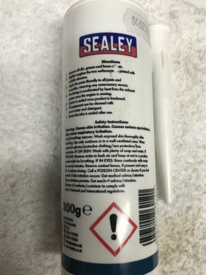

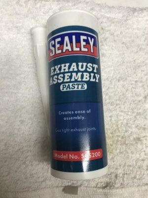

Seems to be a more common practice in the UK. When I was redoing exhausts in my son's and my car I purchased this and had it shipped from the UK. Seals and hardens when you run the engine.

I thought it was pretty common. I've been using exhaust paste/cement for decades.

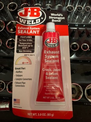

Finally got around to fixing my leaks. I used JB Weld sealer that my local auto parts shop had and leaks are gone and car is now performing perfectly. Surprised small leaks from the clamps could cause such a performance issue. I put the sealer on the outside of the headers and the inside of the mid-pipe and reused the same clamps. Since the pipes in the back were both the same size and didn't slip inside, I applied the sealer to both sides of the pipes and also to the clamps themselves.
