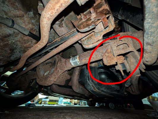

Sunday at 9:30 AM #1 E elmscent Junior Member Joined May 21, 2026 Posts 1 Reaction score 0 Location toronto I bought a pretty beat up 2011. Does anyone know what this rusted out part bit is? I'm not too concerned about the axle or even the control arm box, but definitely curious about this mystery component. Any ideas?
Sunday at 11:04 AM #2 G GriffX Senior Member Joined Sep 28, 2017 Posts 1,558 Reaction score 1,076 Location Rural Germany Wow, that is rusted..... It is a vibration dampener. It has a bolt and you can remove it. The idea is that just by increasing the mass, some frequency from the rear axle are blocked and cannot go to the LCA and the chassis.
