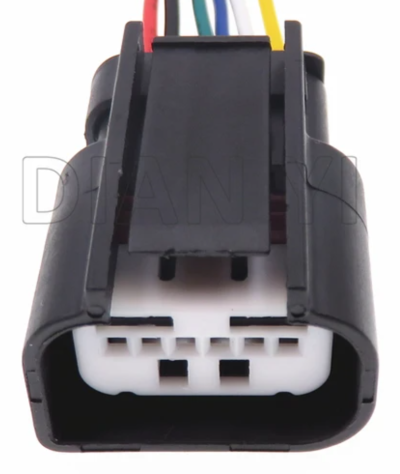

But if you already have a camera, you will need to change the connector to connect it.

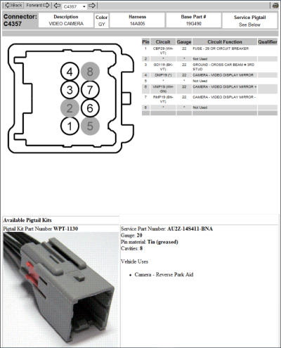

On the standard connector contacts this is the arrangement

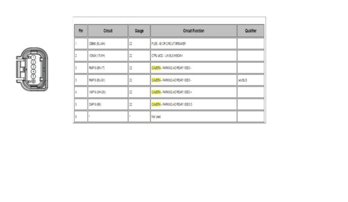

The new connector has this arrangement

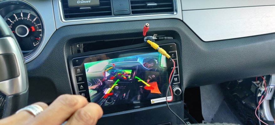

On my Android tablet I got this image quality.

I used a camera from a 2017-2020 Ford Fusion. Part number HS7T-19G490-AE.
