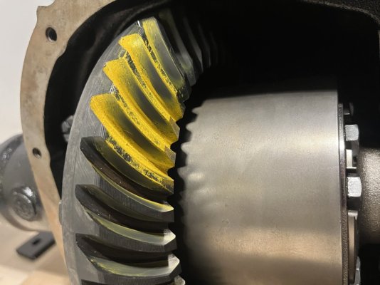

Hello, this is my first post and my first axle rebuild!
I’m currently in the process of building the 8.8 with 4.10 gears and a truetrac. I’ve finally got the pattern as best as I can get it at least I hope. I’m wanting to know thoughts on this pattern. Does it look acceptable?
I’ll probably be installing it within the next week.
The pinion shim currently used for this pattern is .021”

Thank you guys!! I pressed that pinion bearing on and off like 10 times trying to find the perfect pattern. I actually changed the pinion shim to .023" because it looked a little better and my backlash is .008" to .010" I took the measurement in 4 different spots. I started driving it Friday and so far it drives quietly. Also here’s a pic of what the .023” looks like for anyone curious
