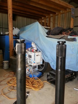

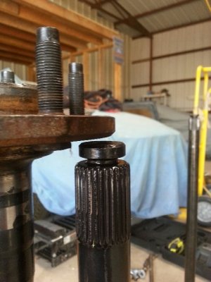

So I recently purchased some axle shafts made by Alloy USA. Had them installed and the driver's side caliper hanger was rubbing against the rotor. Pulled the axle out and it was slightly shorter (maybe 1/8") than the original axle. Contacted Summit, had them send me a new one for the driver's side, as the passenger's side had no clearance issues at all. It arrived and it was too short as well.
I looked at different lengths and can't seem to find a definite answer. Alloy USA lists theirs at 31 11/16" and 32 13/16" (LR & RR respectively) while Moser lists theirs at 31 13/16" and 31 11/16". Dorman has the same sizes as Alloy USA.
I contacted Alloy USA and they said theirs are the same size and all the other manufacturers. Am I losing my mind? There were no clearance issues before and the new ones are definitely different sizes than the ones that came out.
The original axle is on the left in both pictures

Damn, what a pickle.
I have Mosers and no clearance issues. What's the length of your stock ones?
Being that Alloy USA's given specs are 1/8" shorter than Moser, I'd say it sounds like Alloy USA is off on their specs.

Stock ones are the same length as the Mosers. I've been in touch with Alloy USA. At first they said their axles are the same length as all other manufacturers.
AFTER I told them Moser's were different they said "I couldn't tell you why they are different. We've been selling them that length since 2005 though."
Real cool. So far the LR caliper had to be replaced because the piston was seized and wouldn't twist at all. Just replaced that and the bearings had so much strain on them that I'm going to have to replace those...again. Going to Ford Tuesday to get a diagram with the axle length so I can send it to Alloy USA and see what BS response they have to that.

So if stock length is same as Mosers' dimensions...... I'd say that Moser is right and Alloy is wrong.
What more does Alloy USA need than "I measured the axle that came out against the one you sent me as a direct replacement, and it's 1/8" too short. Fix it" ??
Too late to send it back and go with Mosers?

They are taking no blame for anything. Their only defense is that they have been making them that length since 2005. Luckily the guys at Summit are extremely helpful. They are paying to have these sent back and are giving me a discount on the Mosers. That is customer service IMO. They are also investigating why the axles are manufactured incorrectly.
