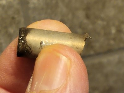

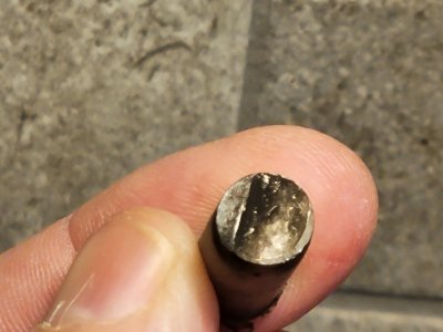

So I may have found the culprit. I got the car up on stands and peered around. The engine and exhaust were cold. I found the forward exhaust mounts from the cross member and they seem solid. What I did find is that the exhaust hangers to the rear of the axel displayed a shiny area about 1/2 inch in front of the rubber in the hanger. Like the exhaust was somehow moving back or expanding after the axel 1/2 inch. It has a Roush exhaust and there is 1 hanger past the axel and 2 hangers for the muffler. The end of the rear hanger on the drivers side was about the same distance from the body. There were marks on the body that matched up with the end of the hanger. But the body was not shinny like it had been rubbing. It looked indented like the hanger was hit against it like a punch would dent steel when hit with a hammer. It almost looked burnt and the end of the hanger looked that way too. So I cut off about 1/2 inch of the hanger. The passenger side had over an inch of clearance. Hopefully this was the culprit. Going for a drive now to find out. Wish me luck!
