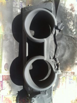

ok so i painted it, not to sure i like my own work. i'm not very good at painting shit. i made a couple booboos that can't be fixed so i might just buy a bullit mustang dash and replace everything

Any pics of this "shitty" work?
it's hard to tell in the cellphone pics as i could get "good" lighting. but the texture just wasn't what i wanted it to be. i wanted a smooth matt black and all some came out ok but was very blotchy looking and feeling i was able to sand it to smooth it out half way decent. some of it was very rough. i trade sanding it with even 320 and could get it to smooth out much. i may look into getting the stuff i want hydro dipped. or get like is aid the bullit dash. i'm horrible at painting i might have it professionally done
anyways here's the pics. the beer was lunch in 100+ degree weather. didn't even wait to get home walked to 7/11 and popped it open in the parking lot lol.

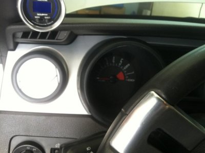

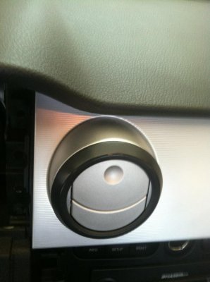

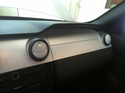

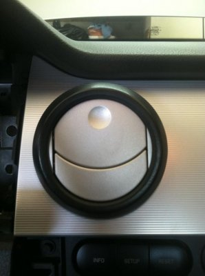

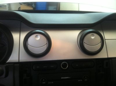

Thanks for resurrecting this thread... Totally doing this this week! Can't decide on gloss or flat black. I don't have a very, and my cars black... I was thinking of painting other interior parts gloss black, so I guess that's my answer... But, what if I did the vents flat and the rings gloss? Any suggestions?
this may help just got them back adn put them on today, so you can see gloss black vs matte black
