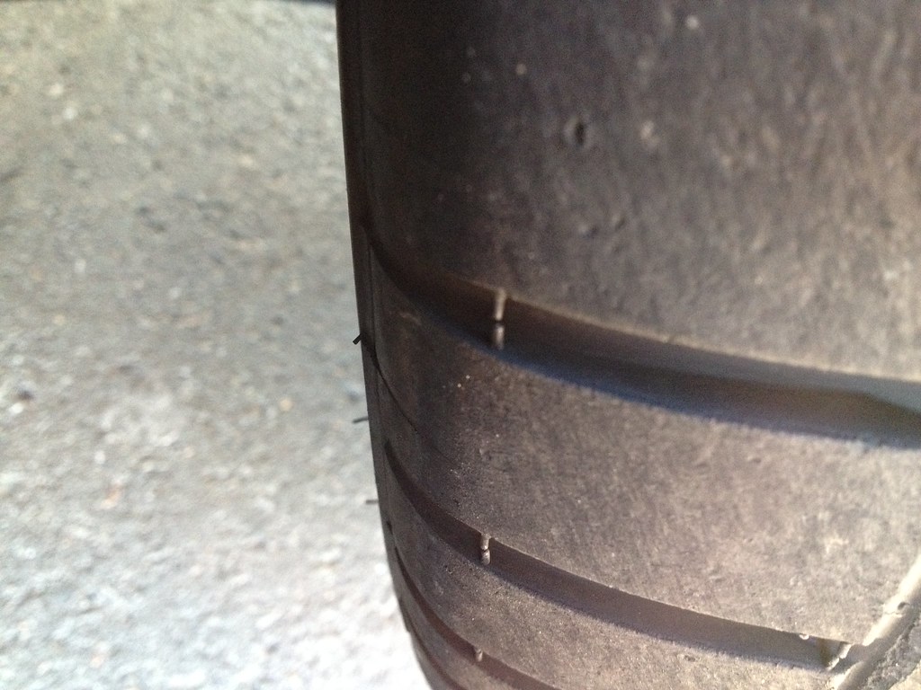

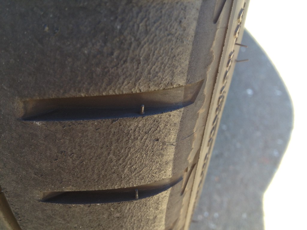

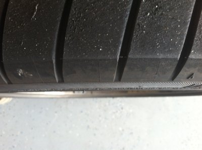

And the tires? The tires are wearing evenly left to right. I have proof. The manufacturer left little "fingers" in the tread on each side at what looks like a set height above the bottom of the tread. Substantial wear on one side or the other would eliminate those "fingers" on one side while leaving them intact on the other. That's not the case for my tires: the "fingers" are intact on both sides and, more importantly, the distance from them to the top of the tread at those locations is about the same.
Here, I have pictures. Here's the outside edge of the front right tire after the event was done, before I drove home:
Outside edge front right by n2185x, on Flickr
Here's the inside edge of the front right tire:
Inside edge front right by n2185x, on Flickr
The outside might be wearing slightly more than the inside, but it certainly doesn't look like a whole lot of difference to my eyes.

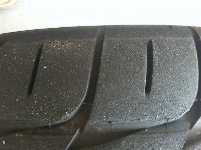

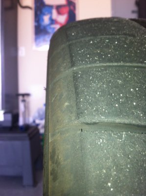

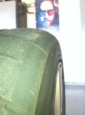

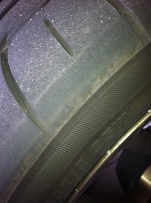

I wonder about the ideal wear too on the RE-11. I see arrows on the side now that I look, but I always tried to get the wear pattern across the tread before it starts to curve down. Don't know if that is right. Just what I have been doing. Maybe verify with Bridgestone? Vorshlag ran these tires at some point. Maybe not competitively (don't know), but they have experience with them.

You really don't see a difference in wear between the inside and outside edges?
In terms of the tread depth? No. But the wear pattern is certainly more visible on the outside edge.
It's not just the depth I'm looking at either. I'm also looking at the curvature between the two sides, which looks the same.
If the curvature is the same and the depth is the same, then the outside can't possibly be wearing faster than the inside, right?
ETA: it's possible that the tires are just wearing relatively slowly, and that it'll take more abuse to show the uneven wear. They do have a 280 treadwear rating, after all. However, it's now been 5 track days on these tires so far. I would have expected to see much more uneven wear by now if, in fact, they are wearing that unevenly.

KC, I just got off the phone with Terry Jones in the Tech service dept. I sent him pic #3 to look at while we talked and basically said that is as far you want to go. He noticed the lighter scrub on the inside and said that was ok. It is obvious it was a lot less abraised than the top.
I think I had my tires at 1.8* or 1.9* this last go. Tire psi somewhere around 41 or 42 hot.
What psi were you running?

I know you don't think you are seeing wear on the outside edge but (don't read this harshly, that is not the intent) this is a case of logic clouding your common sense.
See how the oustide of the tire looks like the moon, craters and stuff, and the inside looks like you just got back from a Sunday drive? You are using too much outside tire, IMHO you are rolling over on the sidewall too much as well. With the addition of negative camber you should see a wear pattern like you have on the outside across the whole tire.
Well, I am certainly seeing some wear on the outside edge, but in terms of the shape and depth of the tread of that versus the inside, I don't see uneven wear as such.
I definitely see more evidence of "action" on the outside edges.
It may be that, over time, the difference in the "action" will manifest itself in greater actual wear on the outside. That remains to be seen.
That is entirely possible. And it's something I'll address at the same time I go to coilovers.
These tires have, so far, been through 5 days worth of driving events, and I have a lot more coming up in this month alone, so I think if the wear is going to get uneven, it'll probably show itself by the end of this month.

I noted the same. While the tread blocks aren't shorter, they definitely got worked much harder and over time will wear out sooner. I noted the same while I was on stock suspension. I have to watch what the tires are doing now with -2.75 deg camber while racing.
