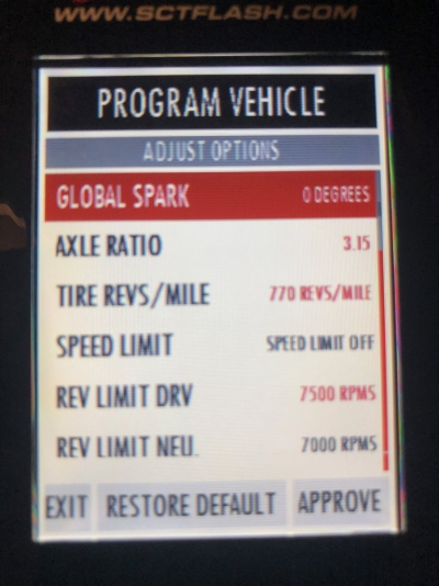

What are you using for a tuning device? I have a Steeda tune on an SCT X4 and I can modify certain parameters such as rear axle ratio, tire revs/mile, etc. Also, even though the tire size indicates a certain revs/per mile, I have found the true number to be higher. For example, my stock 255/40R19 wheels and tires (3.15 axle) based on circumference would suggest 746 revs/mile. Using my tuning device, I had to set that parameter at 770 revs/per mile. I verified that setting using my Dragy, which will give an indicated speed as you simply drive car normally. I usually start at around 30 MPH and keep checking up to around 70 - 80 MPH.

The revs/mile should be approximately 752. (even though the 27.7-inch diameter would suggest 729)
