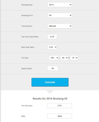

My son has a 2014 3.7 6spd manual and he'll be going to 3.55's with a 6 spd manual you will still get great fuel economy and the car will be a comletely different ride. If you want to accelerate you'll be higher in the rpm band which makes for a far superior/enjoyable ride.

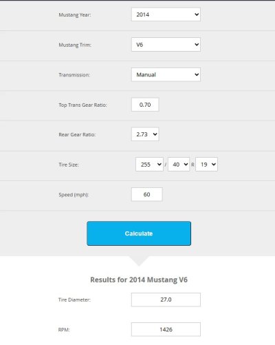

You guys really need a piece of software to calculate the rpm for a different gear ratio when you have 1500 @ 2.73 ?
What for? You have me! ;)
