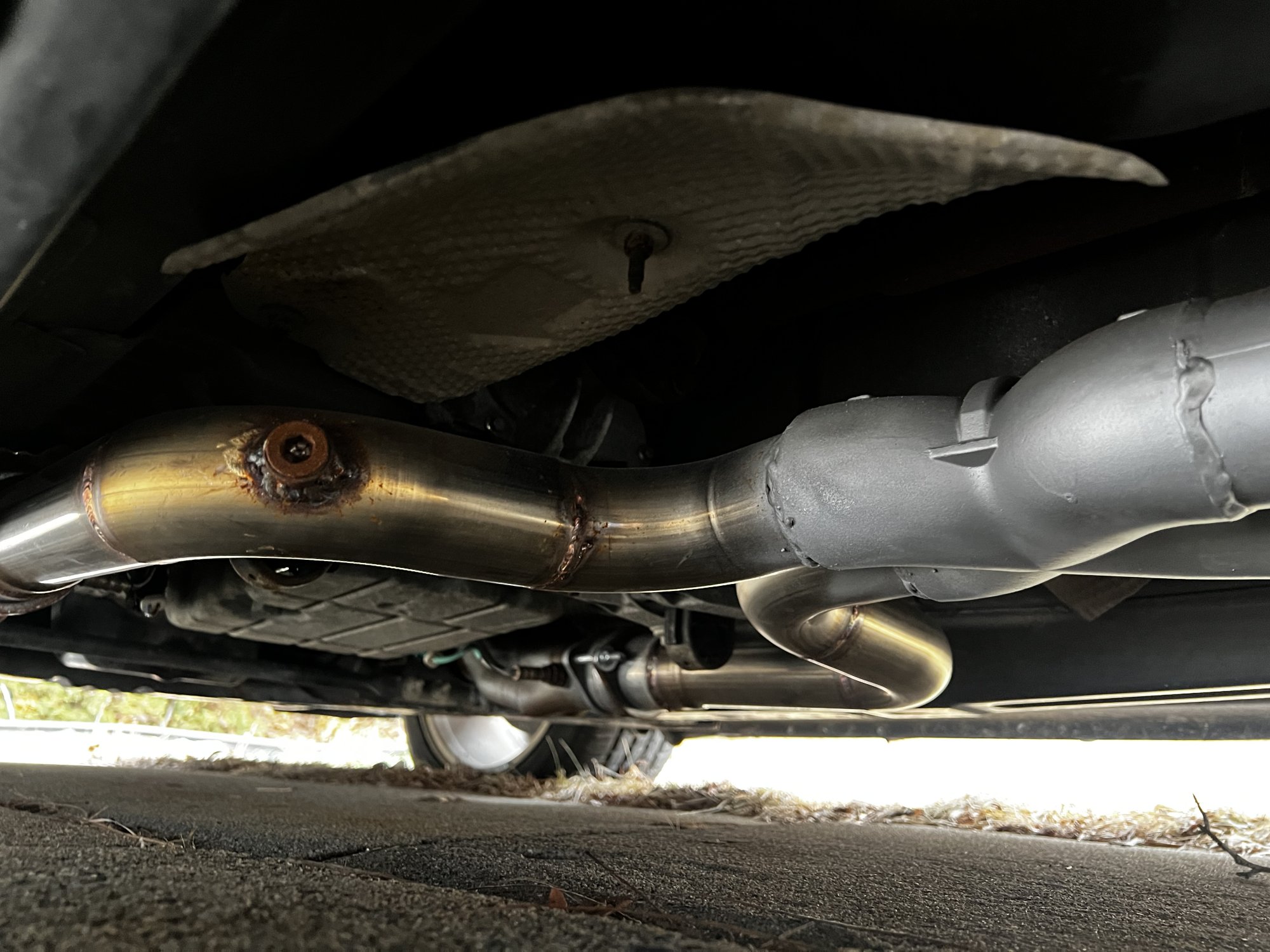

The car is currently owned by a college kid who's had it just 8 months and has too many other vehicles to keep it. The mods were reportedly all done by the previous owner just in the last couple years. That owner had it for about 7 years. We're trying to get detailed records on the mods. The cam, phasers, coils, and plugs are all newer. I has a new throwout bearing, and the mechanic said the current aftermarket clutch had about 60K left on it. The clutch felt good when driving. No audible noise indicating worn timing guides. The car has 180K miles on it. With these mods, it needs 91 octane gas. The suspension sits too low and scrapes speed bumps, but it's adjustable and can be returned near stock height.
We drove it tonight, and it was surprisingly streetable. No real torque below 3000 rpm, as expected from the big cam. The exhaust is really loud needs to be replaced with some real mufflers. The Lito tune is specific to the removed cats, so we probably won't change that. The body's in decent shape, although the unpainted fiberglass hood looks tacky.

Obi-Wan-YJ, Dino Dino gives sound advice. How he fits all this information in his head is beyond me. I bought a 2007 GT automatic w/75,000 miles on it for $11,500. Cai, 3:73 Detroit Locker, BBK long tube headers, catless, X pipe, resonators and last but not least American Thunder mufflers.The work and tune done by Lidio.
I am extremely happy and impressed with the performance and best part it’s turn key!
Oh, and stock cam W/93 oct tune.
