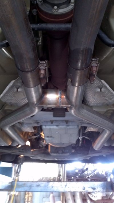

I had Lidio do the work that you described. I didn’t want the X pipe. Didn’t care for the raspy sound, but Lidio said not necessarily. Anyway BBK Long tube, X pipe, resonators and American Thunder (moderate/aggressive)+tune. No drone and plenty of complements
StockishS197 She sounds fantastic!!!

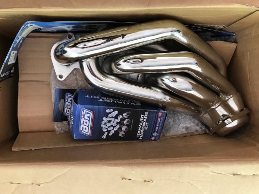

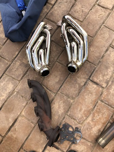

I have custom made 2.5" mandrel-bent off-road H-pipe. BBK shorty headers and stock 05' GT mufflers. I normally would go with LT but got the shorty's new in box for $100.00. Car has been running this system for over 10 years and zero issues, but I am also in the FREE STATE of Florida! I will try to get a clip of the, but don't have a YouTube account to host...
FYI I had OEM Ford Bullitt's on my 06' GT Convt but that car had cats and stock exhaust manifolds, it just gave it a nicer sound. 2016-02-12_09-25-06_163.jpg2016-02-12_11-23-56_15.jpgIMG_0652.HEIC.jpg

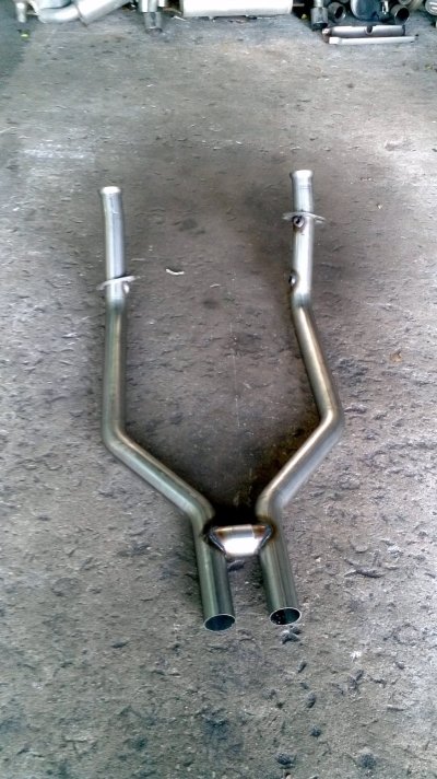

Yeah I’m having an exhaust shop fab an H pipe from the catted bbk x pipe I have, I think I prefer that classic muscle car tone the h gives. I’m in Canada, lots of guys go catless, but it’s a big fine, don’t want to worry about it. Canada is increasingly less free in more ways than this!
