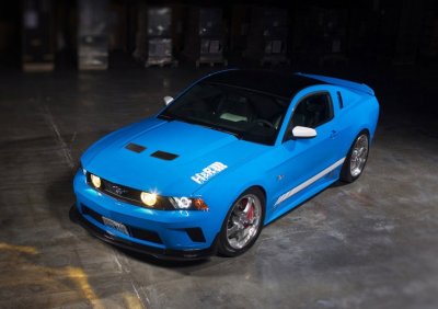

I'm curious to see what kind of improvement you could realize with the stock cooling hardware and improvements to airflow routing. The stock radiator seems well shrouded, but between the small grill opening and high pressure zone under the hood at speed, there is a lot of room to improve.
Since the newer one piece GT500 heat extractor vent won't fit well on the GT's cowl, I'm giving some thought to ordering and dropping in twin vents from the older GT500's:
7R3Z-16C630-AB
7R3Z-16C630-AC
I don't have any dimensions for them, but my eye thinks they could fit nicely side by side, just behind the start of the cowl. This would give airflow a great path to pass through the radiator and out the hood. Adding a more open grill (or modifying the stocker) would improve this even more. So not only would you be passing more air through the radiator, you will be extracting hot air from under the hood (better intake temps), avoiding high speed instability from excess pressure under the front of the car, and even modestly improving aerodynamic drag.

A quick chop to show the idea...
